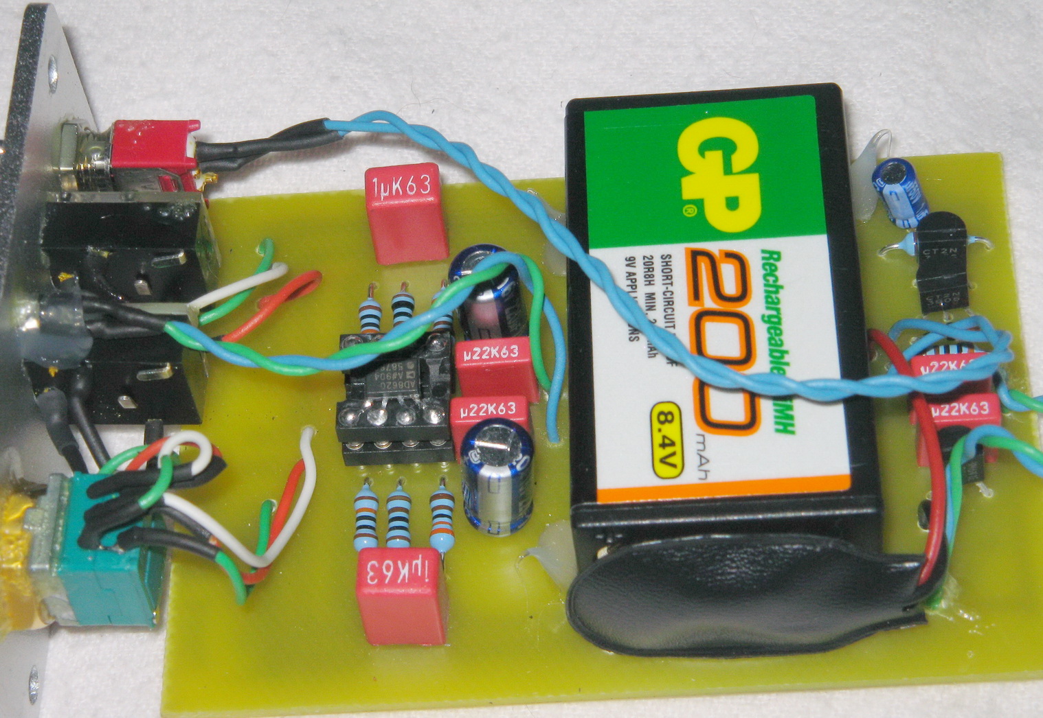

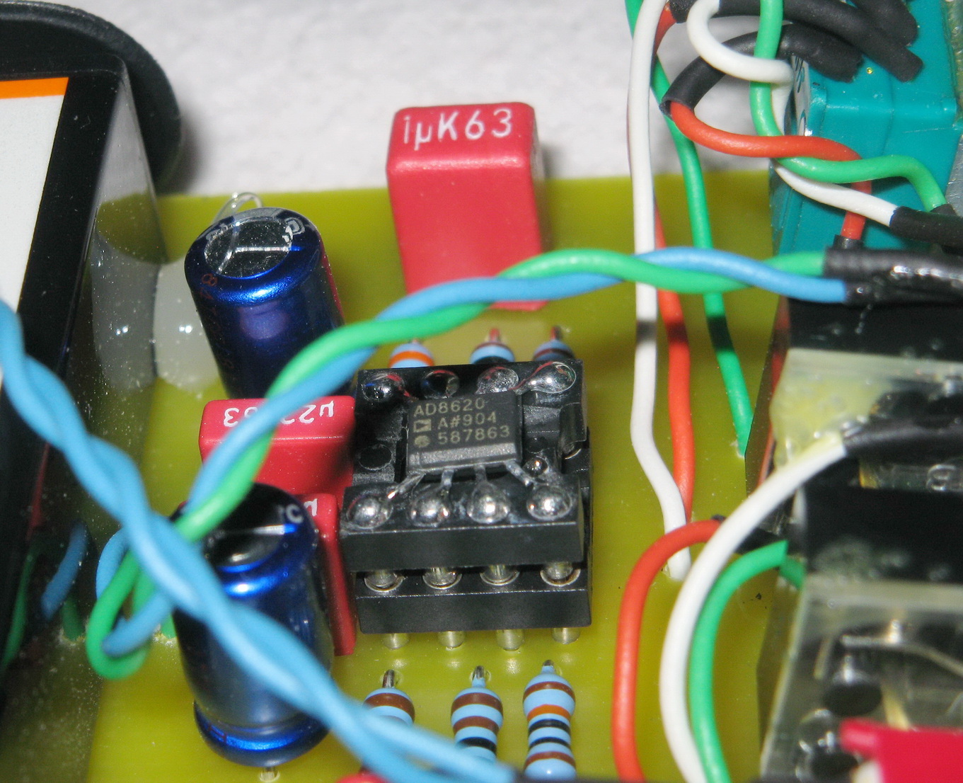

Post by JohnnyBlue on Feb 12, 2011 21:40:04 GMT
Managed to prise open my Neco Portable Mk.1 version, and am posting a couple of snaps, so you can compare them with those of Mike's V.2 posted on page 1 of this thread. My Mk.1 has the upgraded op-amp, but there's only the one (AD8620), the V.2 has dual mono (AD8610) op-amps:
Post by PinkFloyd on Feb 13, 2011 2:37:03 GMT
Looks good Johnny If you decide you like the opamp that is in it then I would lose that second dip8 socket and just solder the one with the opamp on it direct onto the board. How is it for juice? last quite a long time between charges?

Post by JohnnyBlue on Feb 13, 2011 8:32:18 GMT
Looks good Johnny If you decide you like the opamp that is in it then I would lose that second dip8 socket and just solder the one with the opamp on it direct onto the board. How is it for juice? last quite a long time between charges? Ah, thanks for explaining that arrangement: I wasn't clear what that was all about with the two DIP8 sockets. My guess is that Neco built them that way so he could easily upgrade the op-amp if such an order came in. What it does mean, though, is that I can now start delving into the murky world of op-amp rollng! Any suggestions as to what could be an improvement that would work without my having to alter any of the other components? It's difficult for me to estimate battery longevity, because it's one of a number of portable HPAs I use, so I lose track of how many hours any particular one goes before needing a re-charge (or, more usually, inserting freshly re-charged batteries). If you twisted my arm, I'd guesstimate between 10 - 20 hours.
