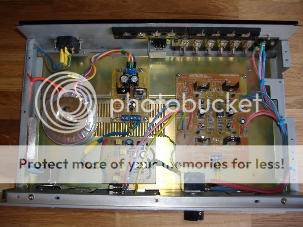

Post by rossman on Mar 9, 2009 11:24:21 GMT
My rebox of the SCHA from SandyK which was given to me while I was in Aus last year for those that haven't already seen it in the main SCHA thread. [img src=" i474.photobucket.com/albums/rr101/rossman1965/Picture131-1.jpg"][/img] This is my own build from scratch. All enclosure parts are recycled from other bits of kit. Wiring and layout is a bit messy because I messed up and drilled the holes for the pot and switch the wrong sides of the front panel.
Post by rbrook on Mar 15, 2009 13:03:15 GMT
Finally got the camera out. Not the final layout still need to fit in the JLH when it arrives and finish off the front panel.

Finally got the camera out. Not the final layout still need to fit in the JLH when it arrives and finish off the front panel. Hi Richard, well very frelling nice like the LCD VU meter excellent Robert

Post by rbrook on Mar 15, 2009 14:15:44 GMT
Ha Ha !
Is that one you prepared earlier?
If you want to mount the LCD away from the board i found an old Floppy drive cable did the trick just fine.

Ha Ha ! Is that one you prepared earlier? If you want to mount the LCD away from the board i found an old Floppy drive cable did the trick just fine. well I was thinking of it as well ha also I like the magnetic shielding, you have put some thought into this haven't you the only other "extra" thing I could think of is a DAC, have a look at Jeff's or other DAC modules out there. ;D Robert
