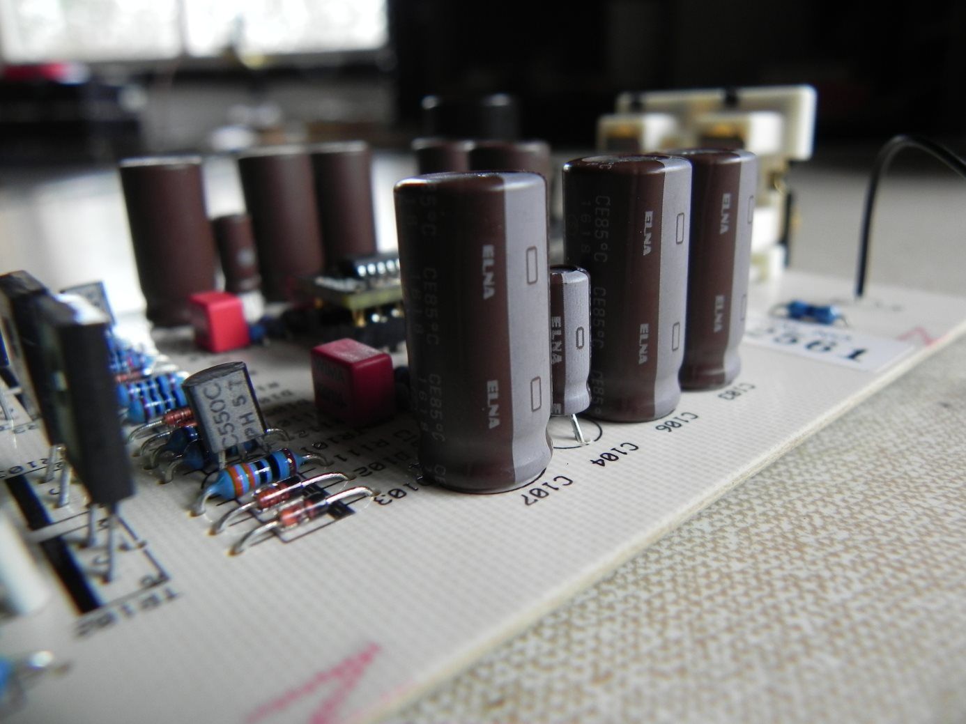

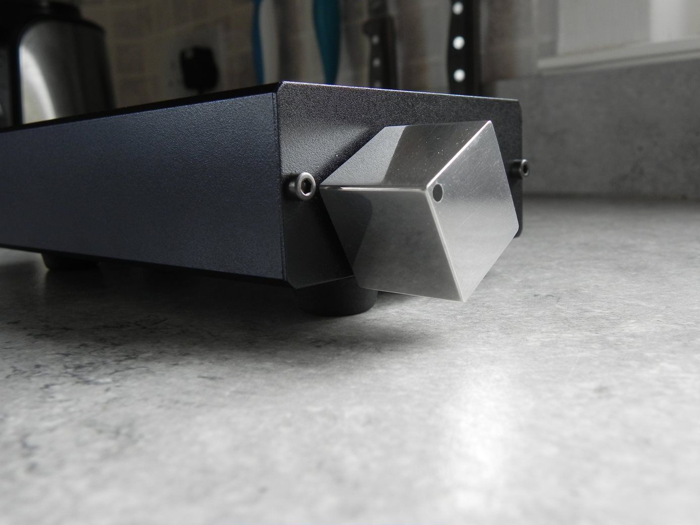

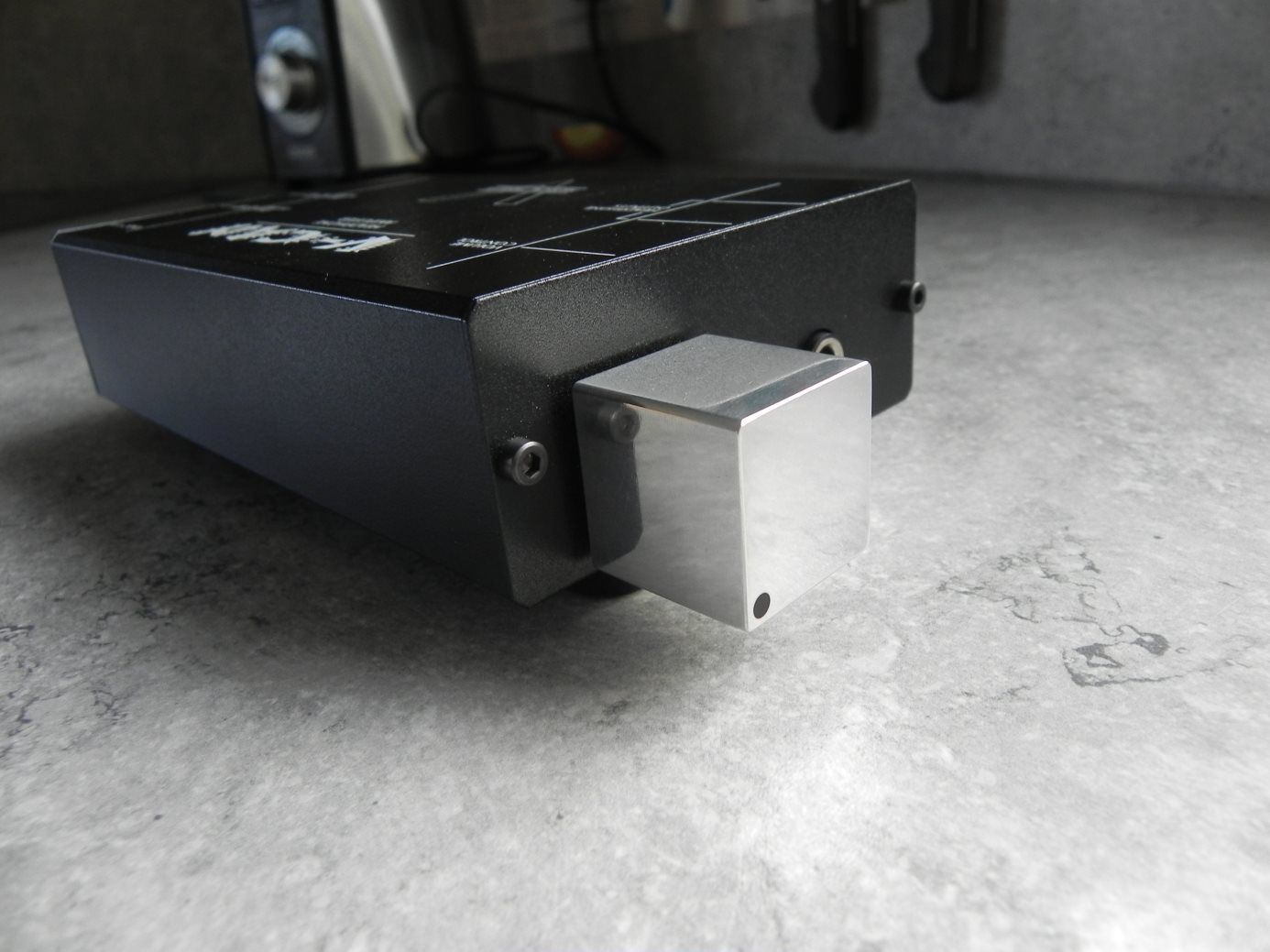

Hi All, Just a quickie (as the vicar said to the choir boy) after fitting these caps and a bit of tape on the pot shaft the very small amount of hum has gone completely. Admittedly it was only very small and only from mid point up with no signal present when you touched the alli knob but it's all gone now, complete silence. BTW these are a tight fit but with a bit of wiggling will go in no probs All the Best Martin Hi Martin, Glad they arrived OK. That's the reason I use the ABS knobs, the aluminium ones tend to cause hum but only when you touch them.... seems the caps have helped

Yes you mentioned the hum but I was willing to put with it as it was such a small amount and the aluminium knob looks so much better
Yes these caps have cured it completely seems an extra benefit. I'll leave it run awhile for all to settle down

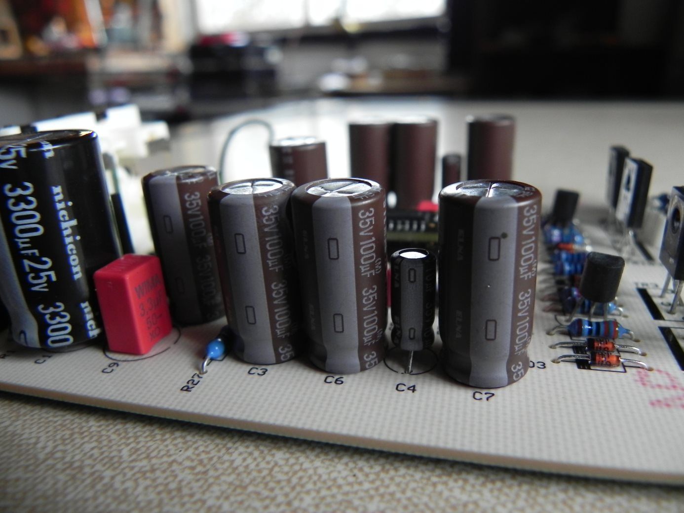

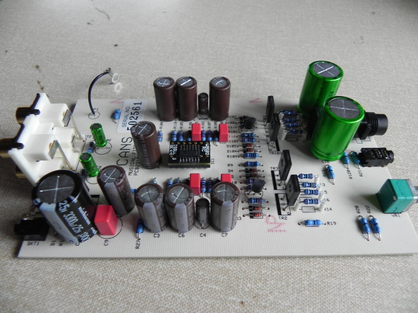

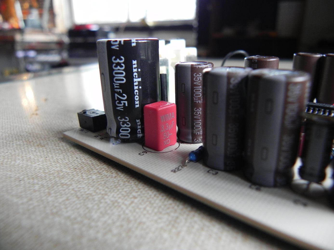

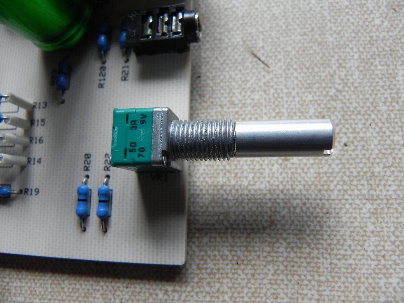

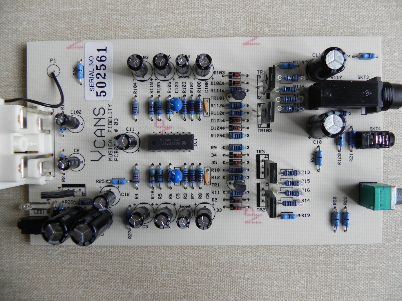

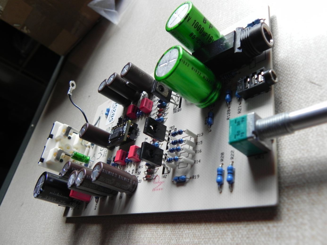

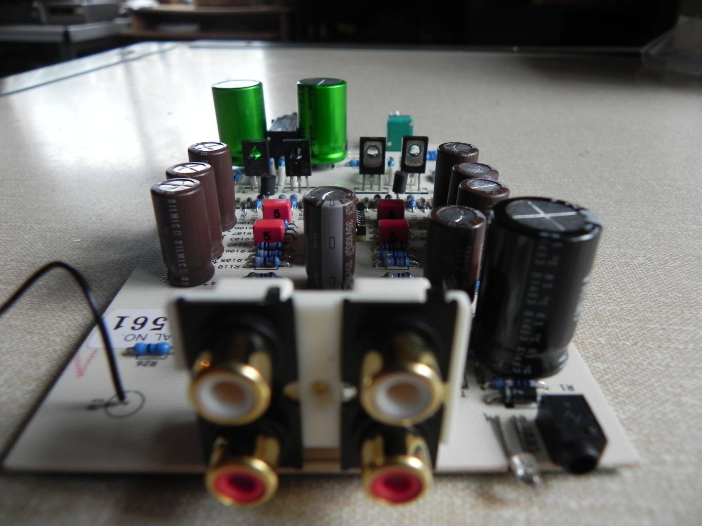

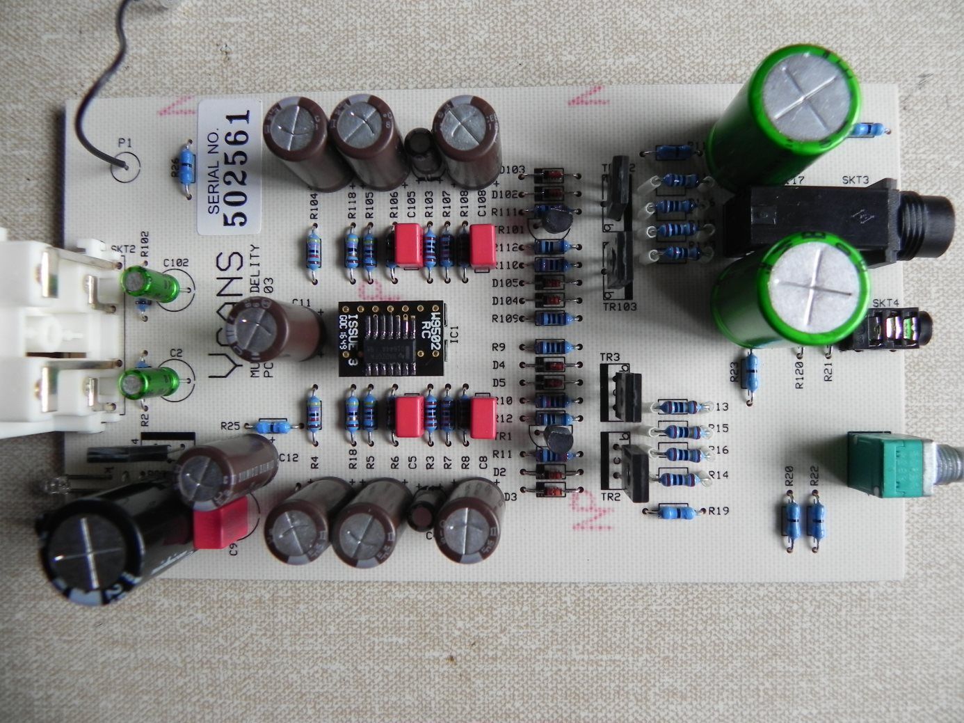

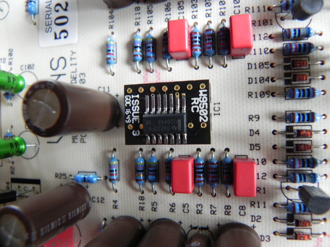

04th October 2017 - Jan Eveleens V-Can Headphone amplifier. www.rock-grotto.co.ukThe Matched one... V-CAN Slideshow (please click) I decided to go for maximum sound quality on this one and really bring the best out of it. I used a combination of ELNA Silmic ll and Nichicon MUSE (these two work VERY well together) and the results, to my ears, are nothing short of amazing.... this little puppy doesn't "purr" anymore.... it GROWLS! Here is the stock amp: Here's the modded one: I got rid of the 2 x 1000uF in parallel and fitted a 3300uF 'lytic and 3.3uF Film cap (in parallel) instead: I matched the ELNA Silmic ll sleeves because I'm a fussy bugger that way: The transistors were removed and tested, they were ALL OVER THE PLACE so I hand matched two perfect pairs (Hfe 140 on all four transistors) and binned the stock transistors. At the last minute I removed the stock potentiometer because it was, erm, bloody awful.... again, all over the place. I hand matched a pretty much perfect ALPS 50K log and what a difference! both sides tracking within .5% of each other: I removed the stock MC33079, fitted a DIP14 gold plated socket (to enable op amp rolling if Jan ever wants to go down that path) and then fitted an OPA1644 onto a Winslow adaptics SOIC14 to DIP14 adaptor...... the OPA1644 really does inject some life into the V-CAN, night and day compared to the MC33079: I wish they'd produce the OPA1644 in a DIP14 package, the SOIC's seem to be getting smaller by the year Must be my eyesight that's failing. Thank god we can still get hold of "some" large stuff that the ageing human eye can actually "see"..... if all amps were SOIC / SMD etc. I'd stop working on them. The Silmic ll / Nichicon MUSE combo really paid off in this amp.... gorgeous organic tone with plenty of macro detail. So much so that I'm going to supply these with the upgrade kit from now on..... this little amp (The V-CAN) has always been tricky to get just right and I've tried a lot of different things with it over the years but the simple matching of transistors / matched potentiometer / OPA1644 and Silmic ll / MUSE combo was all that it needed. Was it really 8 years ago when the "world first" under the bonnet pRon was revealed? rockgrotto.proboards.com/thread/3895/house-bonnet-exclusive Jesus, time is flying by WAY too fast!! ELNA Silmic ll / Nichicon MUSE / WIMA / Burr Brown OPA1644 / Matched BD139 / 140 transistors / Matched 50K ALPS potentiometer. Another HUGE upgrade was the solder...... the V-CAN is full of that unleaded shite, I desoldered each and every joint and reflowed with lead rich (2% silver) solder..... that "green" solder strangles the SQ big time (it really does) and it's a pig to work with, requiring higher than normal temperature to melt the bloody stuff.... I won't get started on my utter hatred of lead free solder but will finish off with a few photos of one amazing sounding V-CAN: Finished off with a pretty unique square knob
