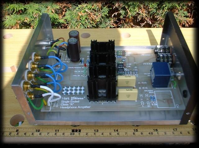

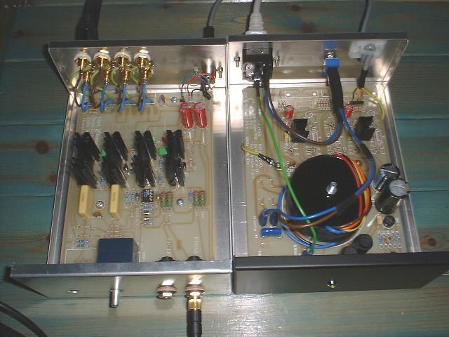

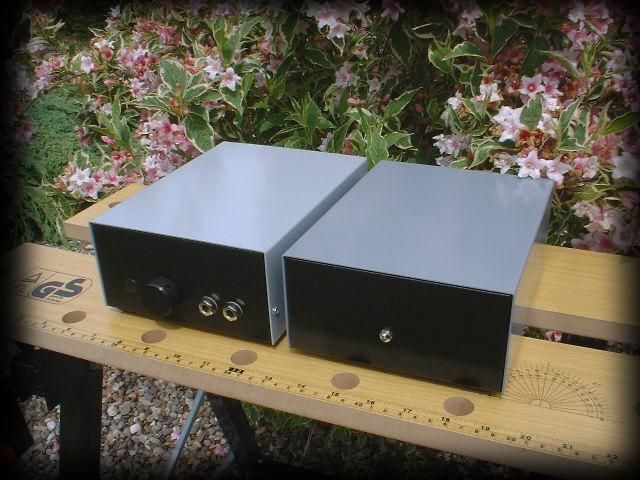

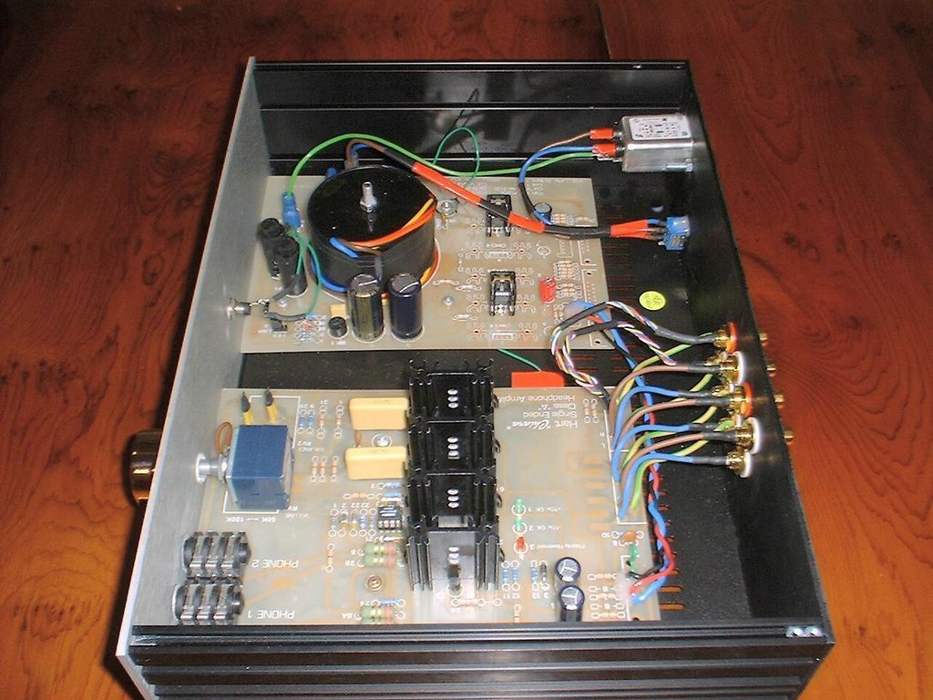

Hello I thought I would start a thread to show all the units and mods I have made over the years, using this single ended class A headphone amplifier. people may know me as jamesfeline and I have posted before on this forum so just as a reminder I will add a couple of pics More to follow as I work through various builds etc just for info I have a couple of boards on Ebay currently, a small part kit .. but does come with new OPA627 metal can op amps (original purchased from RS) Link just incase you are interested below www.ebay.co.uk/itm/251957664194?ssPageName=STRK:MESELX:IT&_trksid=p3984.m1555.l2649regards

Hi Mike well done .. give me a few days to put the package together for you, I will more then happy to help with the build etc, i will let you know when posted .. should be mid week or end of the week. I will try and start collecting the parts as promised in the ebay sale regards Nick Hi Nick, Great, many thanks, I look forward to receiving the bits and bobs and getting started on the build. Your one (in the above pic) seems to have a lot of bells and whistles added, it will be interesting to find out what they are. That's a very professional job and I like the look of the enclosure. The enclosures that Williams supplied were very basic, they came as bare steel and you had to spray paint them if you wanted a "finish" on them: I put those together about 12 years ago. There will be hundreds of photos on here somewhere as I built quite a few and most of them housed in Galaxy (Italian) enclosures: Excuse the quality of the photos, digital cameras 12 years ago were not what they are today and you had to keep the upload size small thanks to "dial up" speeds I've had a look in the archives and I have all my original Chiara / Andante notes so it will be a breeze putting it together with a few updated tweaks..... a lot of water has gone under the bridge in twelve years and a lot has been learnt so really looking forward to building a Chiara 2015. All the best, Mike.
