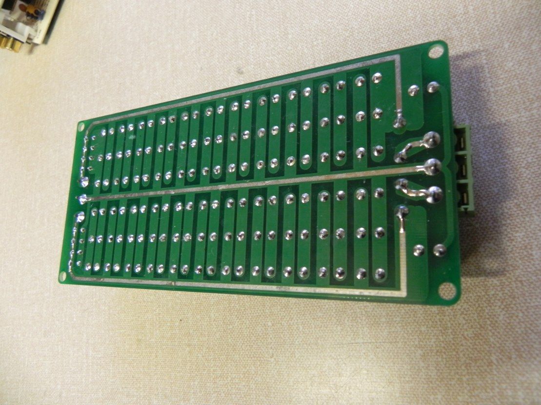

Post by PinkFloyd on Jun 22, 2015 12:46:51 GMT
Nick...... second opinion..... does this look right enough to you?
Post by Deleted on Jun 22, 2015 16:21:38 GMT
Had a quick look .. yes looks ok to me But will have another check to make sure

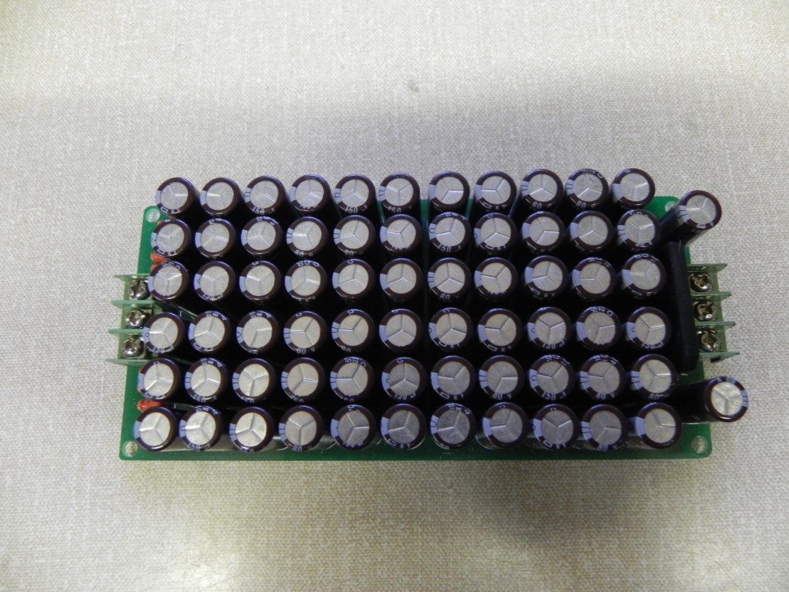

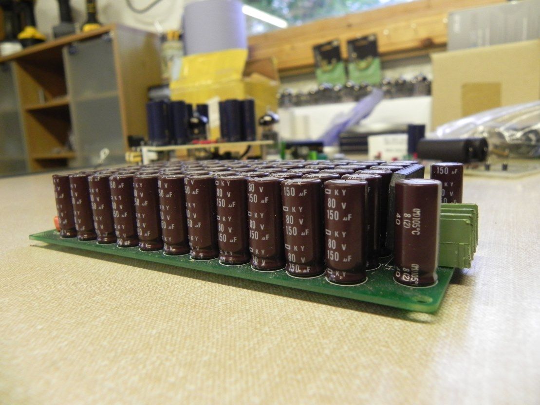

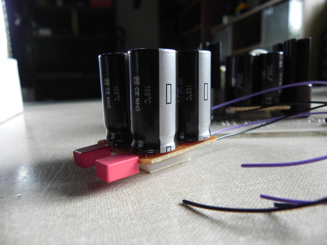

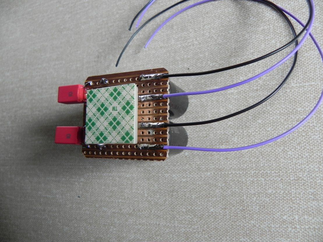

Post by PinkFloyd on Jun 22, 2015 19:26:22 GMT

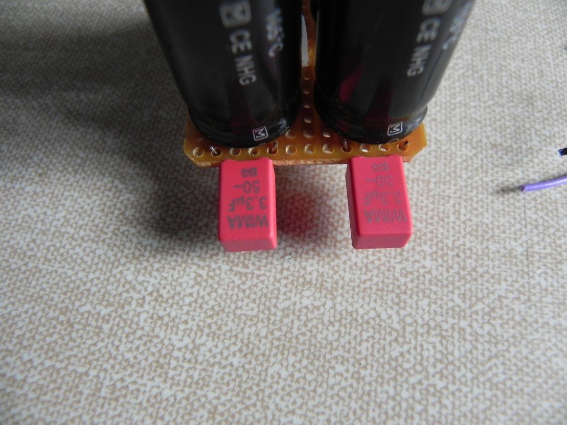

Had a quick look .. yes looks ok to me But will have another check to make sure Nick I always like to double check Nick I made another one today, a "MKll" version which I will send over to Adrian..... it's basically the same 2 x 3300uF in parallel per side but this time bypassed with a 3.3uF film cap: There's room on the PSU board to fit an "add on" cap board with 6 x 3300uF on it so I'll probably do a MKlll version tomorrow 2200uF is pretty paltry but 2200uF PLUS 9900uF gives a much bigger reservoir of 12,100uF to draw from

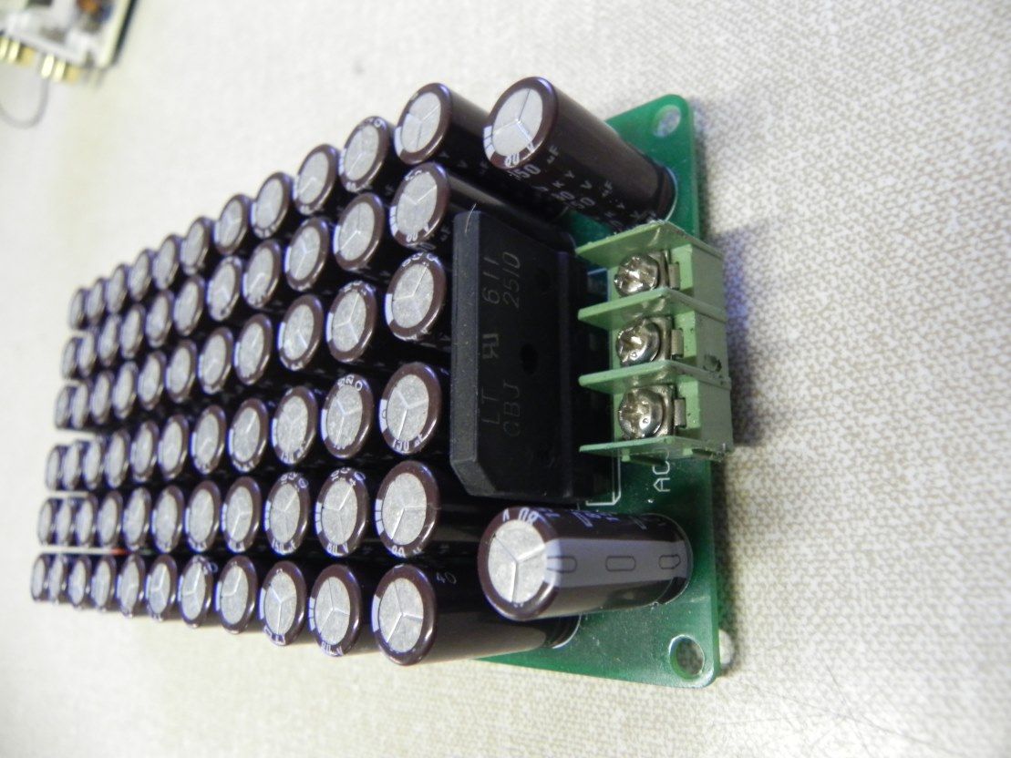

Post by Deleted on Jun 22, 2015 21:18:32 GMT
Mike Just remember that the JLH PSU Add-on when used with parallel 4,700uFs already has a simulated capacitance of around 1 FARAD . Regards Alex
