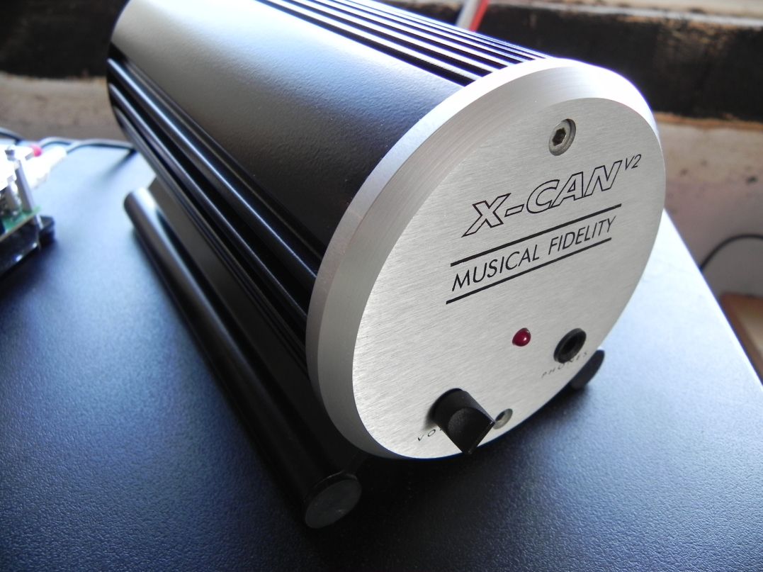

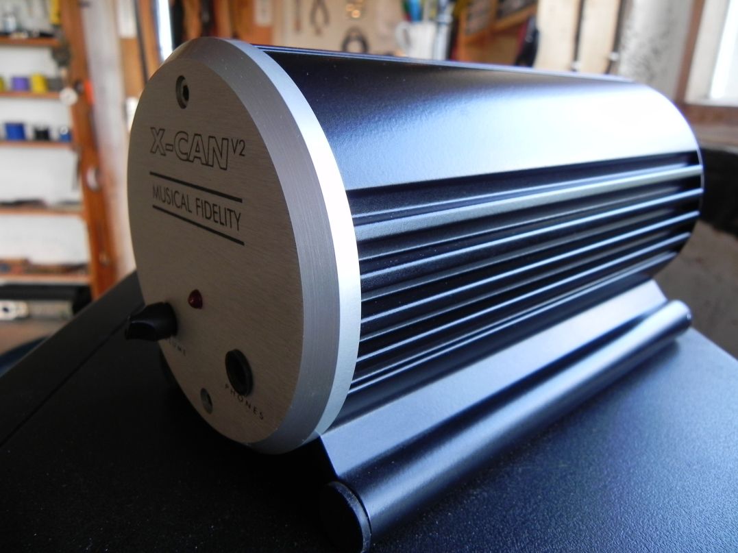

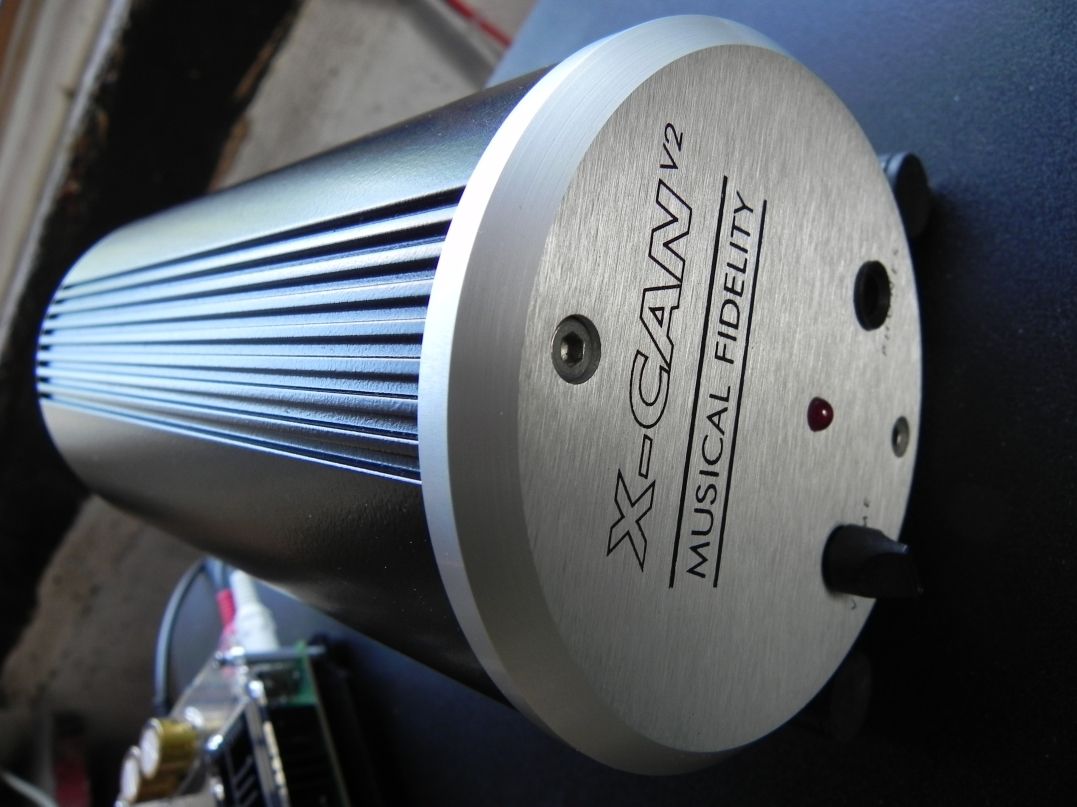

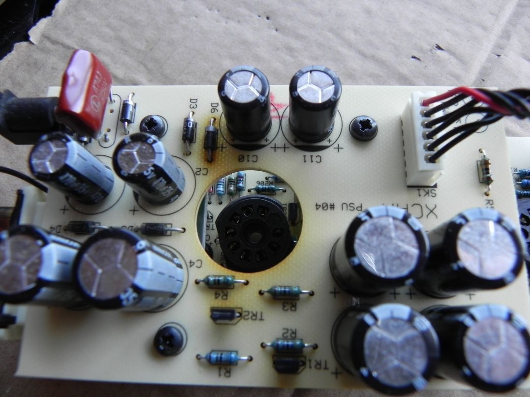

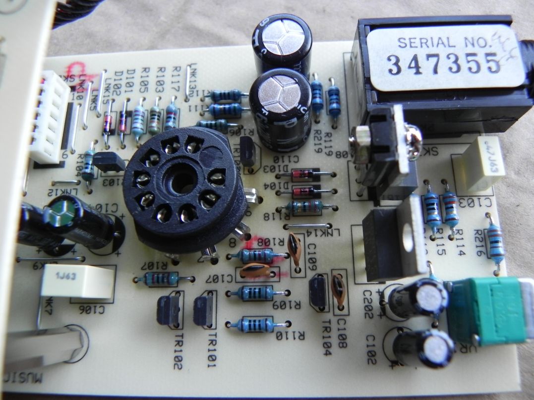

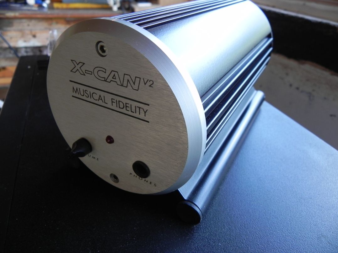

Post by PinkFloyd on Apr 11, 2015 20:32:58 GMT

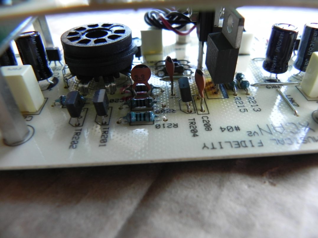

Hi Dave, The enclosure is pretty much perfect but there are a couple of slight heat marks on the PCB but these are to be expected and are only slight..... not like that one you had Laurent's V2 was in absolute pristine condition because he had never used it (had seldom used it) from new. I would be more than happy to recommend this one to you, all the pads are 100% sound and it's easy to prevent the diode on the top board making contact with it, I fit UF4004 diodes and raise them above the board. Yep, overall this is a VERY clean example and will go on for years and years. If you want it let me know. If not, I will mod the arse out of it and sell it thus: New 2.1mm DC socket Jalco pro headphone socket ALPS potentiometer Matching knob New gold plated quad phono socket Purple / blue LED 105c rated Panasonic FC capacitors UF4004 diodes MUSE coupling capacitors Ceramic valve / tube sockets Pair of precision matched triodes / 6H23N Russians 60/38/2 silver loaded solder / Warton metals English solder Every single solder pad will be desoldered and reflowed with 60/38/2 silver loaded solder I've got a few boxes of TIP110 / 115 transistors so will also fit new hand matched transistors (PEAK Atlas DCA) Anyhoo..... here is the V2 I'm talking about:
