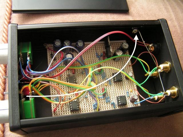

Post by greenstiles on Jul 13, 2013 10:09:30 GMT
Got a chap who says he's knows a lot and was in the industry for a while to build me a tone control unit, it works, but it hums on the treble (only) if the volume is right up and you touch the -/+ knob.........but if you touch any casework of other equipment or it's own casework most of the hum goes, only leaving some background noise.....the bass knob is totally silent regards hum etc.....any ideas ? willing to send to someone to sort out, just as long as it not cost an arm and leg please see link rockgrotto.proboards.com/thread/9180/stand-tone-control-unit-treble

Post by greenstiles on Jul 13, 2013 10:36:06 GMT
Everything is as in pic, but he has recently, stuck (crammed) bigger caps in ? and re-routed the earth path...........i'm not electrically minded, but i know this guy does not know as much as he thinks he knows.............and to be honest, after this 3 fiddle, it is not sounding as transparent as it 1st did, it is sounding a little muted. £60 up the swanny i'm thinking

Post by greenstiles on Jul 13, 2013 10:55:14 GMT
that reduces the event of if i touch the treble knob it hums louder but hum is still there but does not get louder ( when i touch the knob )....but it has added a buzz which wasn't there before..........so when unit is active but tones bypassed was silent, now buzz, when tone active hum still there but not louder when knob is touched, but now with a buzz.

Post by greenstiles on Jul 15, 2013 10:43:20 GMT
it's a diy job, i could try and get the scribbles the guy did i guess, would the pot have an earth solder tab on them ?? if so what do you think of this :
Well i did an experiment today, and i'm getting closer i hope with this earth issue.
I attached a wire to the ground wire you screwed into the chasis which lead off the neg on the back of the jack inputs, and the other end i attached to the nut that is holding the pot in place.......this had stopped the hum increasing when my fingers go near the metal control knob and/or nut.............i feel that if this pot has an earth solder tab on it ?? i would imagine so, then i just need to link the chasis to it and this may resolve the issue.........OR if the low/bass pot has no issue (and is earthed better) running a wire from it's earth tab to the earth tab of the high/treble earth tab.

Most potentiometers have a metal case. You usually need to file s shiny small patch on the passivated finish of the case, and put a blob of solder on that section. You do that to all pots, then run a wire between each of them back to an earth point. You need a reasonable sized soldering iron to have enough heat for that. Another option could be to try something like a piece of copper clad PCB material, tin plate, aluminium etc. behind the front panel and provide mounting holes for the potentiometers. You then solder or screw a wire to the copper etc.and connect it to an earth point. Alex

Post by PinkFloyd on Jul 15, 2013 12:40:05 GMT
Any other ideas from other members ? Only happens when you touch the knob? IIRC those pots have plastic shafts but if they are metal then you could always replace the aluminium knobs with ABS plastic types.... unscrew the knobs and see if the shafts are plastic or metal.... if plastic then see if the problem is still there with the alu knobs removed.... if the shafts are metal cover them in insulating tape and see if the problems goes, if so then fit plastic knobs instead of the alu ones.

It looks like an OMEG pot:
Post by PinkFloyd on Jul 15, 2013 12:46:05 GMT
Post by PinkFloyd on Jul 15, 2013 12:57:19 GMT
What about a wire from the ground tags of the pot to the chassis ground?
