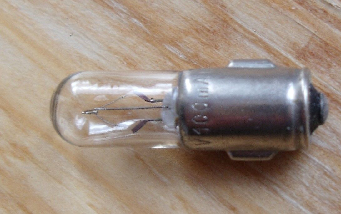

I'm having difficulty sourcing the 6V 100mA lamps for the receiver.... any ideas?
Post by Deleted on Sept 10, 2010 12:05:29 GMT
Maybe you could consider mounting another armature if possible. screw type lamps should be available plenty. Indicator lamps are getting out of fashion... I assume it is for illumination of the tuner dial.

Cheers Jon..... I have sorted the lamps out. All the best, Mike.
