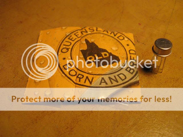

OK to install, here's what I did. remember looking down at the IC the little tab points to pin 8 with pin 1 being the next counter clockwise (to left) fortunately these are pin for pin with the 8pin DIP so carefully fan the leads pin 1 to 4 to one side and pins 5 to 8 the other. I then used a piece of strip board (vero or equivalent) and carefully formed the leads till the bottom of the case was about 5mm from the strip board and square (i.e. parallel to the strip board, we don't want it all wonky ) next I straightened the leads and used a second piece of strip board as a guide and trimmed the exposed leads to the same length, then carefully removed any burs with a needle file and final lead forming with the rolled 8 pin dip socket. keyboard is of course optional yes I know, it's still a work in progress ;D <edit> Robert

Post by jeffc on Mar 12, 2009 9:50:52 GMT
Robert. Gotta luv the packaging , I might just go crack one now Now what might this be funny stuff wrapped in alfoil Nah, just an opamp Much appreciated Robert and like suggested, mine will be getting an initial workout in my elcheapo DAC supplying the SCHA to see whether I can also get some of that Zen-ness. cheers.. jeffc
