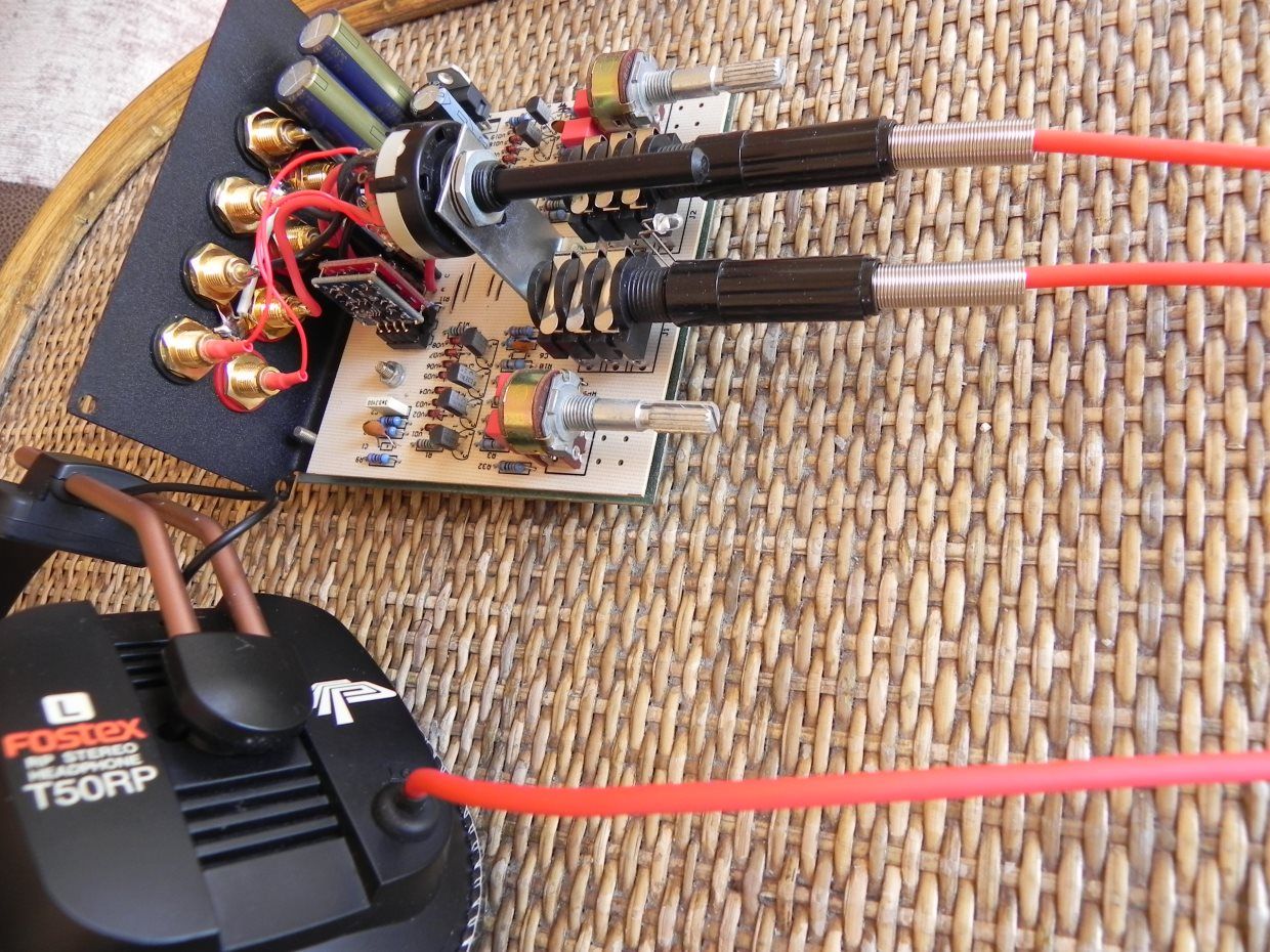

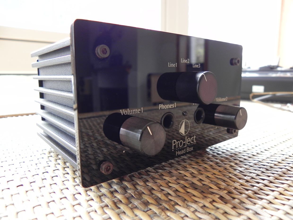

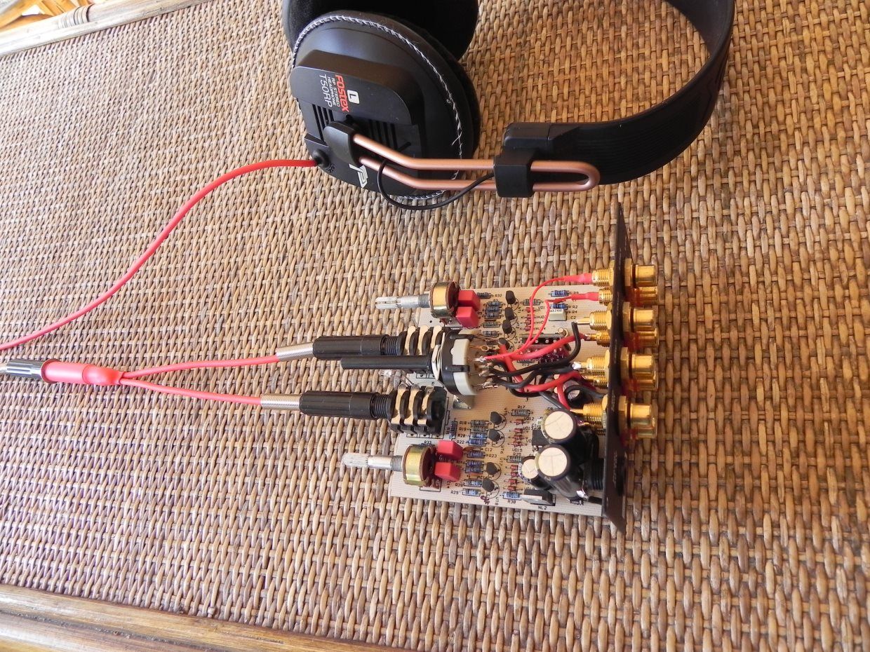

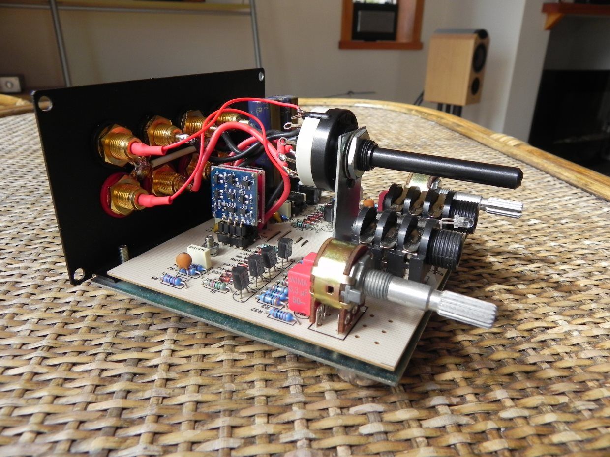

I have chosen the amp I am going to audition the Orange Discrete Opamp in and more on that when I have the opamp to hand. It's essentially two identical amps in one enclosure with a split lead to the headphones so "instant" AB comparison is available at the flick of a switch.

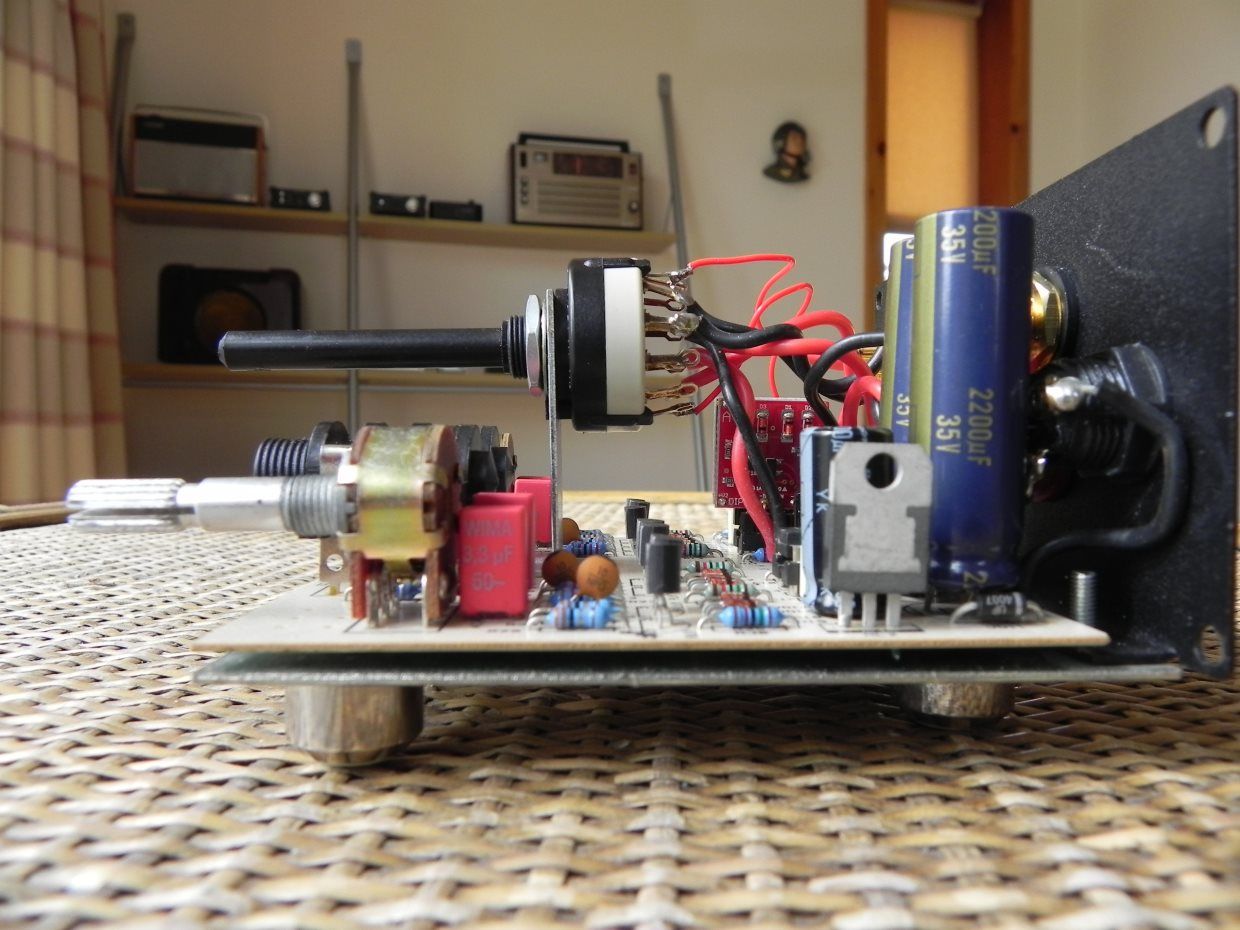

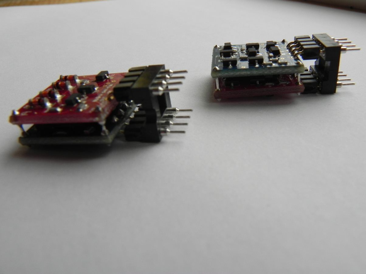

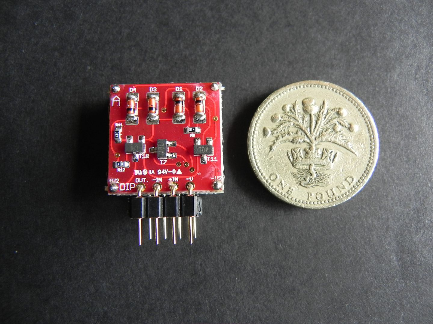

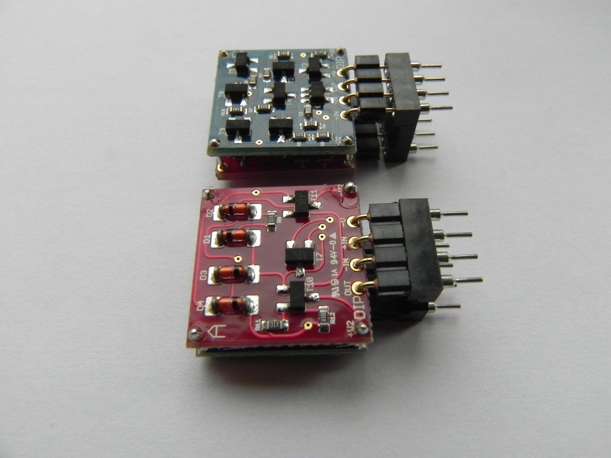

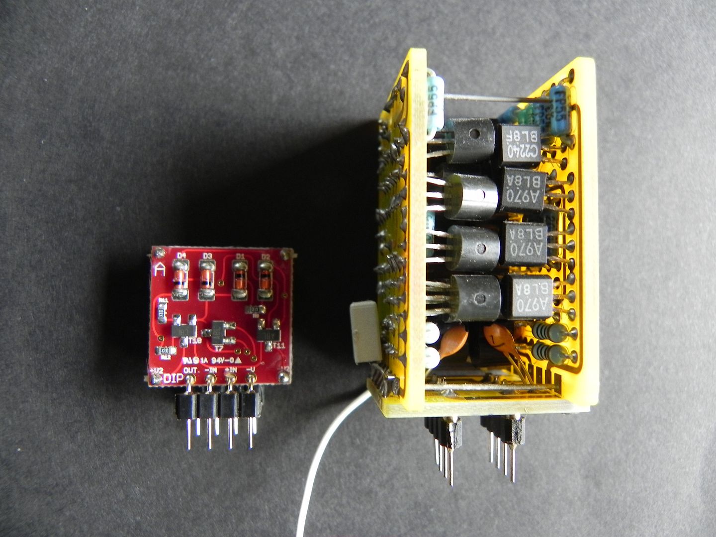

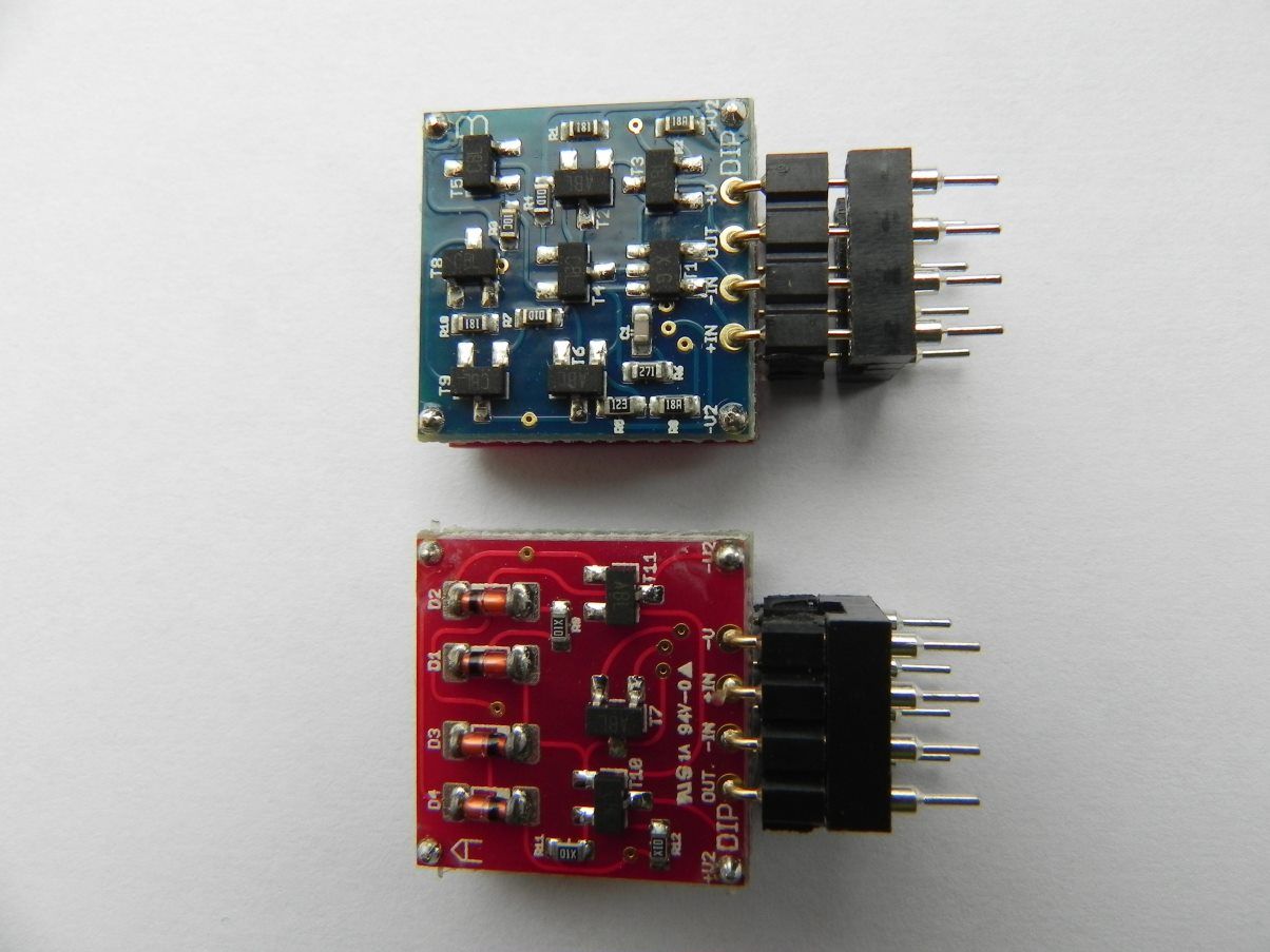

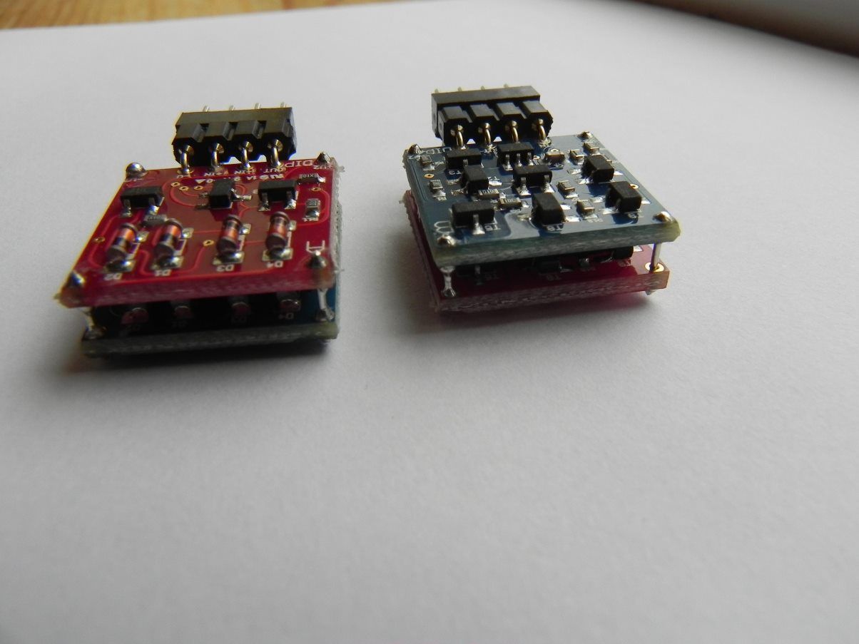

The two Orange Dual Discrete Opamps arrived this afternoon and I can't wait to try them. They come in a plastic "Orange" labelled container and are protected with an anti static bag: These sure are small for discrete opamps (which is a GOOD thing!)..... At last! a Discrete which may actually fit into an amp without having to resort to funky cabling / funky angling. The biggest bug bear with Discrete opamps in the past was not their sound quality, it was their sheer physical size. In most applications, replacing a standard NE5532 with a Discrete was nigh on impossible as the Discrete was HUGE in comparison to the standard opamp and you were faced with height restrictions, width restrictions, component fouling restrictions...... in a nutshell, they were not a "plug and play" drop in for a standard DIP8 opamp and mostly a pain in the arse. If you did manage to find a space in your amp where they could reside it meant running wires to them and we all know that lead inductance is a bad thing right? Look at this classic example..... I think it was a WNA MK1 amp I was experimenting on at the time / about the same time I was in talks with David White to buy the WNA company....... The WNA opamp of choice back then was the seriously crazy (with regard to oscillation) LM6171..... not the sort of opamp you want to be providing to a novice in a kit amp! Anyhoo, long story short, I tried everything in the WNA amp.... I was seriously on the verge of buying the business from Dr. David White so wanted to be 100% absolutely sure..... one of those opamps happened to be a GD Audio Sun Discrete and just look how "discrete" it looked in one of my trials! lead inductance city folks!!! Totally NOT suited for your average headphone amp.... way too big to even consider as a direct drop in replacement for say a NE5532 / OPA2134 / OPA2227 / AD823 / TL072 etc. etc. I'm holding one of the Orange Discrete opamps in my hand (as I type) and it's smaller than a Spangle (remember them?) I'll get down to measuring them tomorrow and comparing them in size to things we all know (like pound coins / love hearts / munchies / SD cards etc but for the time being....... I'm glad to have them, safe and well, and am off to bed soon. My test "comparo" amp has been fine tuned and all ready to go....... TWO amps in one enclosure with a Y headphone adaptor (made it yesterday) to enable a fast "switchable" AB comparo........ more to follow. In the meantime.... a few photos of the Orange Discrete opamps (they are very well made, superb quality in that respect):

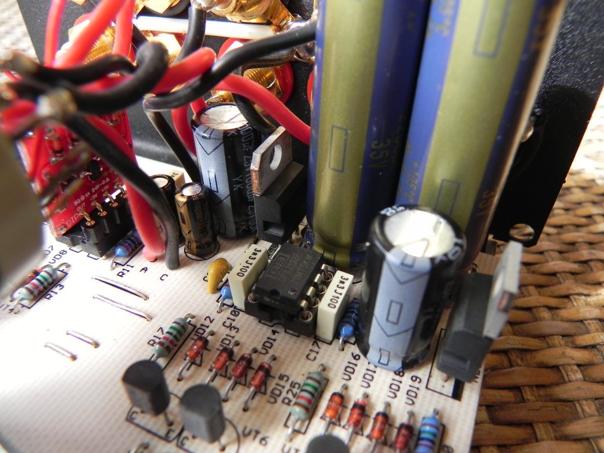

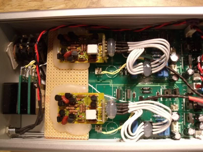

Post by freddypipsqueek on Apr 25, 2017 15:55:00 GMT

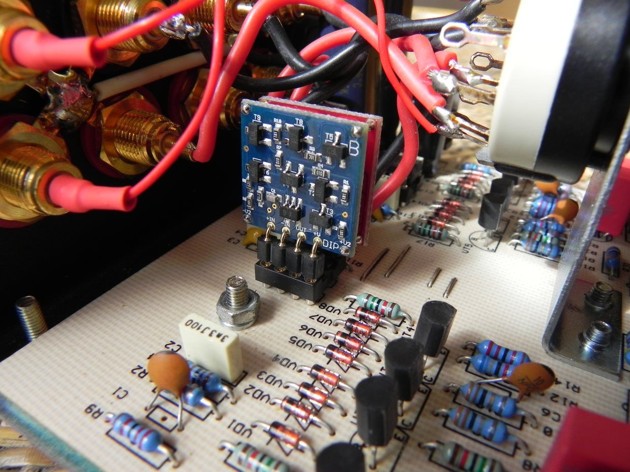

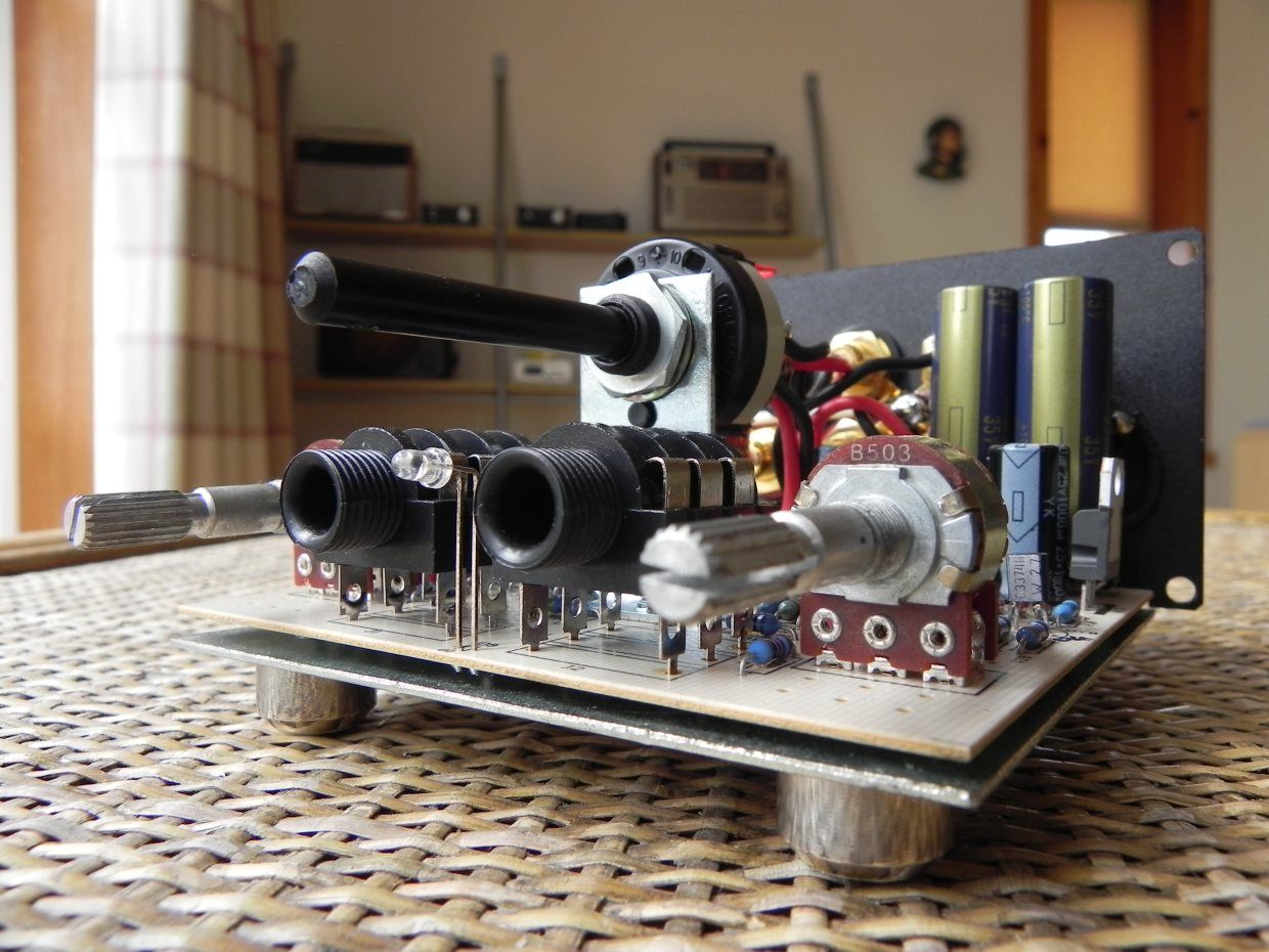

Mike. The WNA was a Mk3 you very kindly did for me - sorting out a few bugs and fitting the op-amps. Since then it has been my reference kit and the Audio GD units (and your work) really made it sing. I am looking forward to your comments on the ornage version with interest particularly as Audio GDs are no longer available. Spangles - Another top product no longer available !!.
Post by PinkFloyd on Apr 25, 2017 20:31:23 GMT
Mike. The WNA was a Mk3 you very kindly did for me - sorting out a few bugs and fitting the op-amps. Since then it has been my reference kit and the Audio GD units (and your work) really made it sing. I am looking forward to your comments on the ornage version with interest particularly as Audio GDs are no longer available. Spangles - Another top product no longer available !!. Good grief! I really did put my foot in it there big time! Sorry about that Mr. Pipsqueek I basically had a look at a few of the traditional discrete "images" I had been involved with and your amp was a prime example of what was available to us back then and the funky angling required to get them onboard. Was that really a WNA MKlll? A lot of years have passed and I could have sworn that was a MK1 or even a MKll WNA. Anyhoo Freddy, take my comments as they were intended....... the discrete opamps of a few years ago were far from user friendly with regard to "slotting in" to available space. The GD opamp was the best available (IMO) at the time and if the WNA with GD is your reference amp then job well done at the time! You are the PERFECT "real world" example to try the Orange opamps and, as soon as I am finished reviewing them, I will send them over to you to try in your WNA.... is that something you'd like to do? You have a couple of GD audio discretes fitted in your WNA..... a shoot out between the WNA with Audio GD discretes and WNA with Orange discrete opamps would be awesome. I am concentrating on the DIP8 opamps such as NE5532 / OPA2134 / OPA2132 / OPA2107 etc. etc. etc. VERSUS the Orange Discrete but it would be really cool if you could do a discrete to discrete comparison Freddy..... up to you man. I've sorted out my amp of choice for the comparison review and all will become clear in the next few days...... just fine tuning the dual amp "amp" to make sure it's as close to perfect, per amp, as can be........ this review will be based on a "quick switch" between channels and will leave no memory effect to the imagination. Back to the looks.............. Same size as a pound coin: A lot smaller than an Audio GD: Next part of the review........... does it sound good?!
Post by PinkFloyd on Apr 26, 2017 19:20:10 GMT
Freddy, just a quick one...... yes, that was a WNA MKlll. IIRC, you had built it and I ironed out a few of the glitches and I fitted the GD Audio discrete to it? Actually, having a good look at the photo (right now) those don't appear to be audio GD discrete opamps..... did you source them yourself and, if so, can you remember what they were? I'm having one of those senior moments but considering the amount of amps I've worked on over the years it's not surprising that I can't remember each one of them That would have been circa 2008 correct? Best regards, Mike.

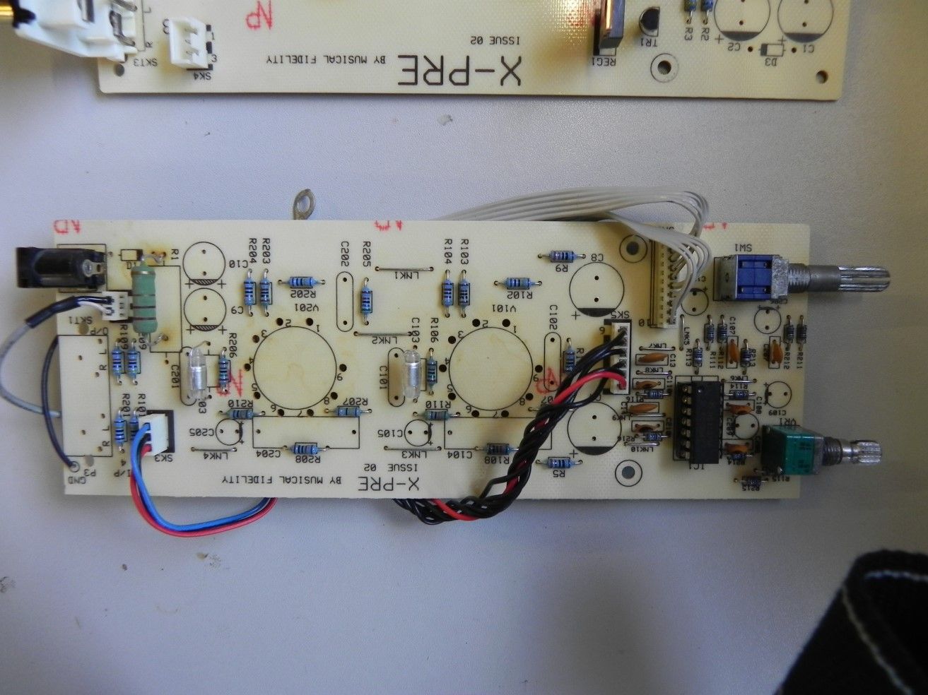

Mike would these or a suitable variant fit in an X-Pre?
Post by PinkFloyd on Apr 27, 2017 18:42:51 GMT
Mike would these or a suitable variant fit in an X-Pre? Hi David, The X-Pre takes a DIP14 quad opamp so I don't think you'll get a Discrete DIP14 quad opamp. You'll get good results with my OPA1644 on Winslow adaptics SOIC to DIP adaptor though: rockgrotto.proboards.com/thread/11255/musical-fidelity-pre-upgrade-moduleThe X-Pre already has a DIP 14 socket fitted so it would be extremely easy to fit the OPA1644:

Post by freddypipsqueek on Apr 27, 2017 22:08:00 GMT
The op-amp's were Audio GD Suns - single units not the usual pair type - I have a Moon 'pair' in my Chiarra - Insomniac sourced them for me. Looking at my emails (and I needed to) it was August 2010.
Please don't apologise for using the photo - I was only mentioning it's history to thank you again for sorting the op amps out. In fact I'm not sure I want to open it up and risk anything but I have a few onther bits of kit - photo stage & Meridian 104 tuner which I am tempted to try with an Orange one. Please though do not put me first in line if there are others wanting to try the spare sample.

Post by PinkFloyd on Apr 28, 2017 10:48:52 GMT
The op-amp's were Audio GD Suns - single units not the usual pair type - I have a Moon 'pair' in my Chiarra - Insomniac sourced them for me. Looking at my emails (and I needed to) it was August 2010. Please don't apologise for using the photo - I was only mentioning it's history to thank you again for sorting the op amps out. In fact I'm not sure I want to open it up and risk anything but I have a few onther bits of kit - photo stage & Meridian 104 tuner which I am tempted to try with an Orange one. Please though do not put me first in line if there are others wanting to try the spare sample. A. Adrian, You will be the first to try the Orange amp. I plan to get this review started over the weekend...... have been very busy with other things. Mike.

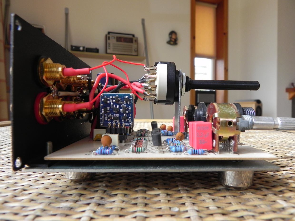

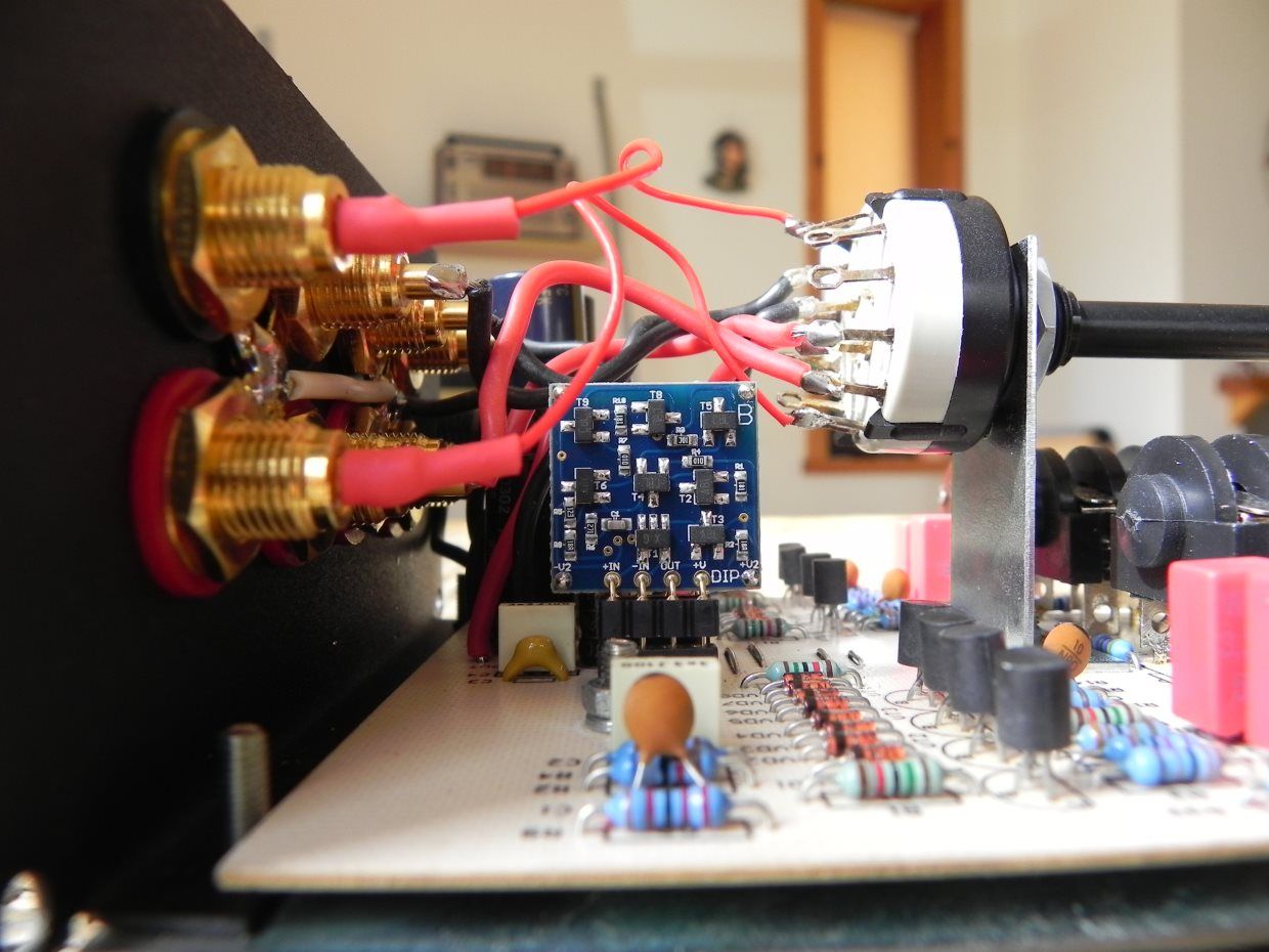

Post by freddypipsqueek on Jun 17, 2017 9:58:08 GMT
These are my initial comments on fitting the Orange Op-Amp into a couple of bits of kit.
Graham Slee Bridge.
This is a budget phono stage (MM) – see here rockgrotto.proboards.com/thread/7419/upgrades-graham-slee-bridge The Orange was swapped out for an AD627 (brown dog etc). The setup was AT440MLa, RB250, Systemdek with a few bits added. There is no notch on the op-amp so check a layout drawing to ensure it is fitted correctly – take care to note the orientation of the opamp being removed. As Mike has said the unit is very neat (inch by an inch by ½ inch) and went into the Slee box (surprisingly) with only the regulator moved round. The Orange has more rhythm, pace, etc – the old “PRAT”. It is quick and fast – to the point that I felt the turntable was running a bit quick !. A bit like 1920's film music creating tension. The treble is good but sharp and I think the unit needs to be run in for while before I come to get a final view. There is no doubt this is a good choice to put some life into a dull component. It had me record swapping. The bass was tight (I think as a consequence of the treble having really good extension). It is easy to listen too but a touch rough and I'm hoping this will smooth out. Classic stuff sounded good with strings light and precise. A real positive was swapping out the 440Mla stylus for a 450 and then ATN103 (£15) showed no change in the presentation. The signature of the sound was a key factor and for running the opamp in I'm much happier using the cheap jobby.

Post by PinkFloyd on Jun 17, 2017 19:49:18 GMT
Hi Adrian, The notch side of the Orange opamp is the side that says DIP..... the DIP end of the chip goes to the notch on the PCB. Your comments regarding the PRAT are very interesting, so much so that I am now biting at the bit to fire my Orange discrete opamp up and have a good listen in the A/B contraption I will be using (the Pro-Ject amp). In my experience (ears only) Adrian, op-amps don't really require any burn in period and are pretty much "there" after the first minute or so of insertion into the circuit. The surrounding passives (caps etc.) DO require a bit of time to form / establish an electron path and, yes, burn-in is more related to passive devices. What PSU are you using with the Graham Slee Bridge? The Orange Discrete opamp draws a bit more current than the AD627...... Should be OK but would be nice to know what the GS Bridge's power supply is rated at. Take your time Adrian, if it takes a year it takes a year...... live with it, listen to it, don't think about it.... just forget it...... keep it bolted down in one part of your system and forget about it. It's the only way to try it out properly..... no hurry / relax and enjoy the music. All the best, Mike. PS: NOT a good idea to begin indoor painting in the middle of June...... I'm going to down brushes right now and get that A/D contraption wired in
Post by freddypipsqueek on Jun 18, 2017 11:00:45 GMT
"The notch side of the Orange opamp is the side that says DIP..... the DIP end of the chip goes to the notch on the PCB."
Thanks - There's so much about these things I don't know yet.
The Slee uses the standard 24v wall wart which is then stepped down to 18v by a cheap ebay regulator in a box. Paul Hynes supplied me with a fancy 15v reg for inside the Slee so ultimately its getting 15v which appears (from the spec sheet) to be about right. The PSU is all a bit too complicated but its does the job.
