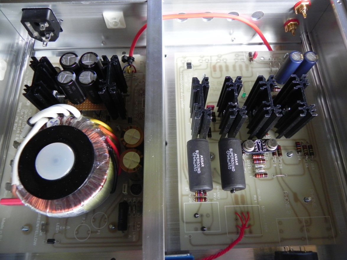

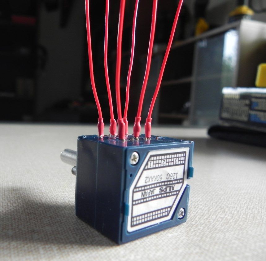

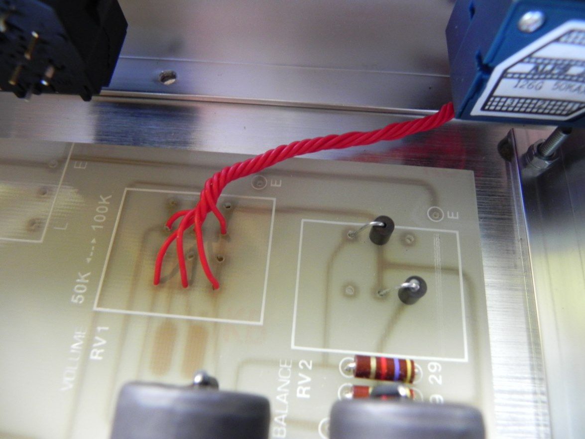

The front panel has arrived in the UK so it should be here any day now so I'll manage to get the amp completed at last I'm just going to stick with the ALPS RK27 (Blue Velvet) pot as it kinda slots into the enclosure nice and neat...... if I were to fit the stepped attenuator it would mean losing the alu shield between the PSU and amp and I'd rather keep that thanks. The pot will have to be wired onto the PCB so I've gone with some solid silver stranded PTFE coated wire. I got a 50 metre roll of this gear many years ago and it's bastard good stuff! You can hold a solder iron tip on the wire all day long and it won't melt, shrink or burn and the pure silver strands (99.999% IIRC) should be nice in the signal path I nearly CHOKED when I saw that some joints are charging UPWARD of £15 per metre PLUS VAT PLUS P&P for similar pure silver wire.... what a damned rip off! That would make my 50 metre roll (well, there's about 45 metres left) worth 45 x £15 = £675 + 20% VAT = £810 ?? Fekk off! somebody is really taking the pish here and they call themselves the "hi-fi collective". Yeh, they're collecting, no doubt about that..... collecting money by the metre! Anyhoo....... another time, another channel regarding "boutique" wires. My RK27, all ready to go:

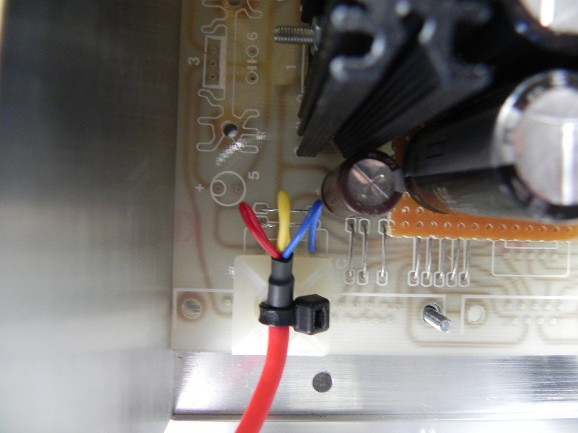

Hey Nick, Hope all is good your end mate........ no need to send those terminal blocks for the PSU to amp hook up as I have decided to hard wire them too........ Sure, they make things easy but I have always been an advocate of the "hard wire" school I'll get this finished on Saturday, I've got fekk all to do on Saturday and will get this hooked up and good to go within an hour (or two) I am going in "hard wired" all the way with red PTFE silver strand wire and red cabling throughout....... I feel a lot more comfortable with my belt and braces hard wired PSU to amp connection: Belt and braces....... solid silver (.999) strands hardwired direct to the pads and secured with a cable tie holder..... that connection is going nowhere apart from staying where it is. A short path over to the amp board: The potentiometer (RK27 ALPS) path to the board will be made via PTFE coated 99.999% solid silver stranded wire.... very tightly twisted in the "pink" style and is 700% better than using mains cable (99 out of 100 cats agree) The pics of the "working" amp will be uploaded this weekend....... it's gonna be well worth tuning in for Mike.
