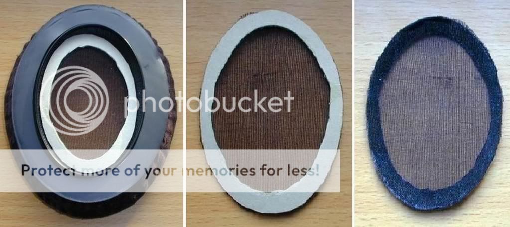

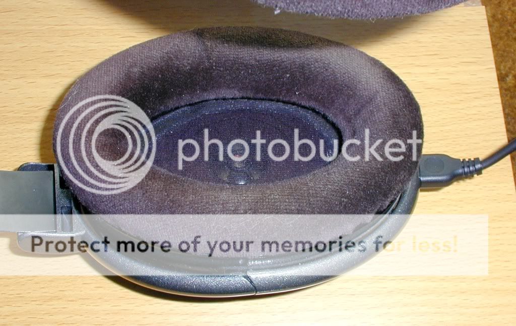

Post by Deleted on Jun 24, 2010 18:37:30 GMT
Mike is absolutely right ! This is how I made my HD650 and Creative Aurvana Live dust filters. Cut a piece of sturdy cardboard to the right shape (smaller then the hole in the pad for the HD650) stretch nylon stocking/sock over a jar or something else that is big enough. Secure it with a rubber band. Put glue on the cardboard ring (everywhere, I used superglue, dries fast) lay the ring on the stretched stocking. Let the glue dry/set. Take it off the jar and trim the edge of the ring. paint the ring (I used a black felt pen). ready.. Does not alter the sound in any way !
