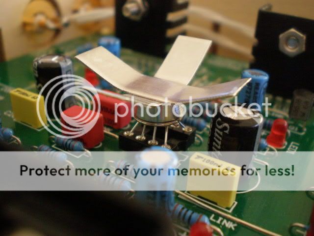

Post by jeffc on Mar 22, 2009 12:12:20 GMT
I was going to give Robert a plug for his perfboard method for forming the LM4562HA pins which works a treat but seems its caught on. Groovy pics. I haven't soldered mine, seems a tight fit though and will be an easy lift if it ultimately finds its home directly soldered into the PCB. The 3M damping material 'wings' seem to do a reasonable job as a heat sink. Sound cheers.. jeffc

I was going to give Robert a plug for his perfboard method for forming the LM4562HA pins which works a treat but seems its caught on. Groovy pics. I haven't soldered mine, seems a tight fit though and will be an easy lift if it ultimately finds its home directly soldered into the PCB. The 3M damping material 'wings' seem to do a reasonable job as a heat sink. Sound cheers.. jeffc shucks er gosh,.. um what sort of plug an IEC, DB9 mmmm ;D looking good but need to ask, why you have R3 and R6 fitted ? looking good

I was going to give Robert a plug for his perfboard method for forming the LM4562HA pins which works a treat but seems its caught on. Groovy pics. I haven't soldered mine, seems a tight fit though and will be an easy lift if it ultimately finds its home directly soldered into the PCB. The 3M damping material 'wings' seem to do a reasonable job as a heat sink. Sound cheers.. jeffc shucks er gosh,.. um what sort of plug an IEC, DB9 mmmm ;D looking good but need to ask, why you have R3 and R6 fitted ? looking good For his next magic trick, Robert is going to show us how to heatsink an LM4562MA !
Post by jeffc on Mar 22, 2009 22:24:58 GMT
OK HS is a bit wacky but it works just dandy . Maybe I'll send Robert some tape to see how creative me can be with it. And thanks for the heads up on the resistor, seems its time I revisited the SCHA documentation and the tweaks thread to put together a to do list, including ditching that WIMA FKP for the ceramic cap that came with the kit. cheers.. jeffc
