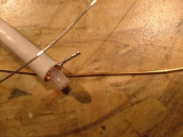

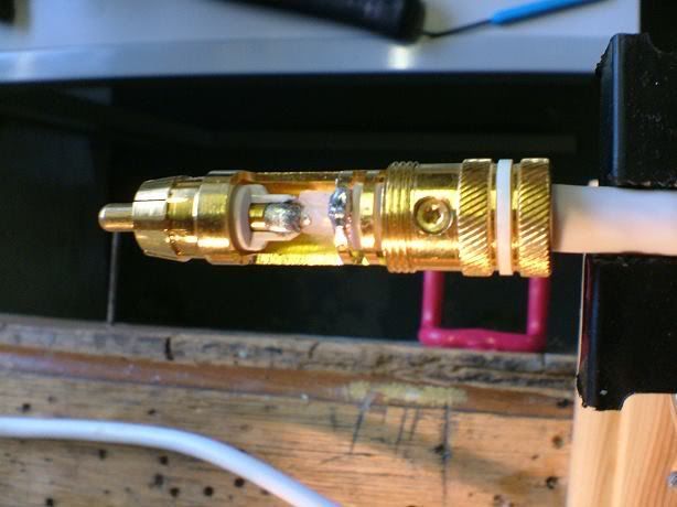

Have built a 0.5metre pair of these today www.gspaudio.co.uk/set_up/cable_1_hi-fi_interconnect.htm and they are actually extremely transparent in use. I didn't exactly stick to Graham's recipe 100% as I'm a great believer in using what you've got. Instead of the CT100 cable I used some WEBRO H109F I had kicking about, the longitudinally overlapped screen is CU Foil (copper), the braid is 54% CU (copper) and the dielectric is 5 cell PE. The capacitance is 56pf/m.... pretty close to the CT100 if not better. The only other changes I made were to strip the stock copper inner conductor out and replace it with a 24K gold plated 1.0mm copper conductor.... I've had this stuff for quite some time and can't remember where I got it but it is 99.9999% OFC with a genuine 24K gold plate. I fed a length of 0.6mm pure silver wire through and terminated it as per the CuGa tutorial, the only difference being I used WTB phono plugs. Took about 20 minutes to make up a 0.5M pair and I'm glad I took the time to do it! You probably all know what I think of "high end" interconnects.... a damned rip off! These CuGa cables cost about £20 (or therabouts dependant on what you have to hand) and are bastard good. The pair I have just made are not stricly "CuGa" as there is an element of 24K gold involved so these are better described as "CuAgAu" where CU = copper, AG = Silver and AU = gold. The solder used was lead / tin so you can add an SN for the tin and a PB for the lead so a more apt name for my particular bastardisation would be "CuAgAuPbSn" (pronounced "kewg-op-bus-en") Fck' it! I can't make a trendy word out of that I'll have to incorporate some iron, some steel and a bit of brass neck Nice cable Graham Pure silver and 24K gold plated OFC copper about to be fed in. Terminated

By FAR the best so far! Crystal clear, extremely open, a noticeable improvement. What are you talking about I hear you ask........... The same H109F cable but this time with the centre conductor stripped out and one length of stripped cat5 in its place, not in the same place either, in one of the bigger outer cells so the cat5 is extremely loose. I got the monster plugs for £1 each and must say I really like them, these will not be going anywhere as there are "2" clamps to secure the cable and boy do they clamp it! So, about £4.40 for these interconnects and they certainly are the clearest I have heard for a long while.
