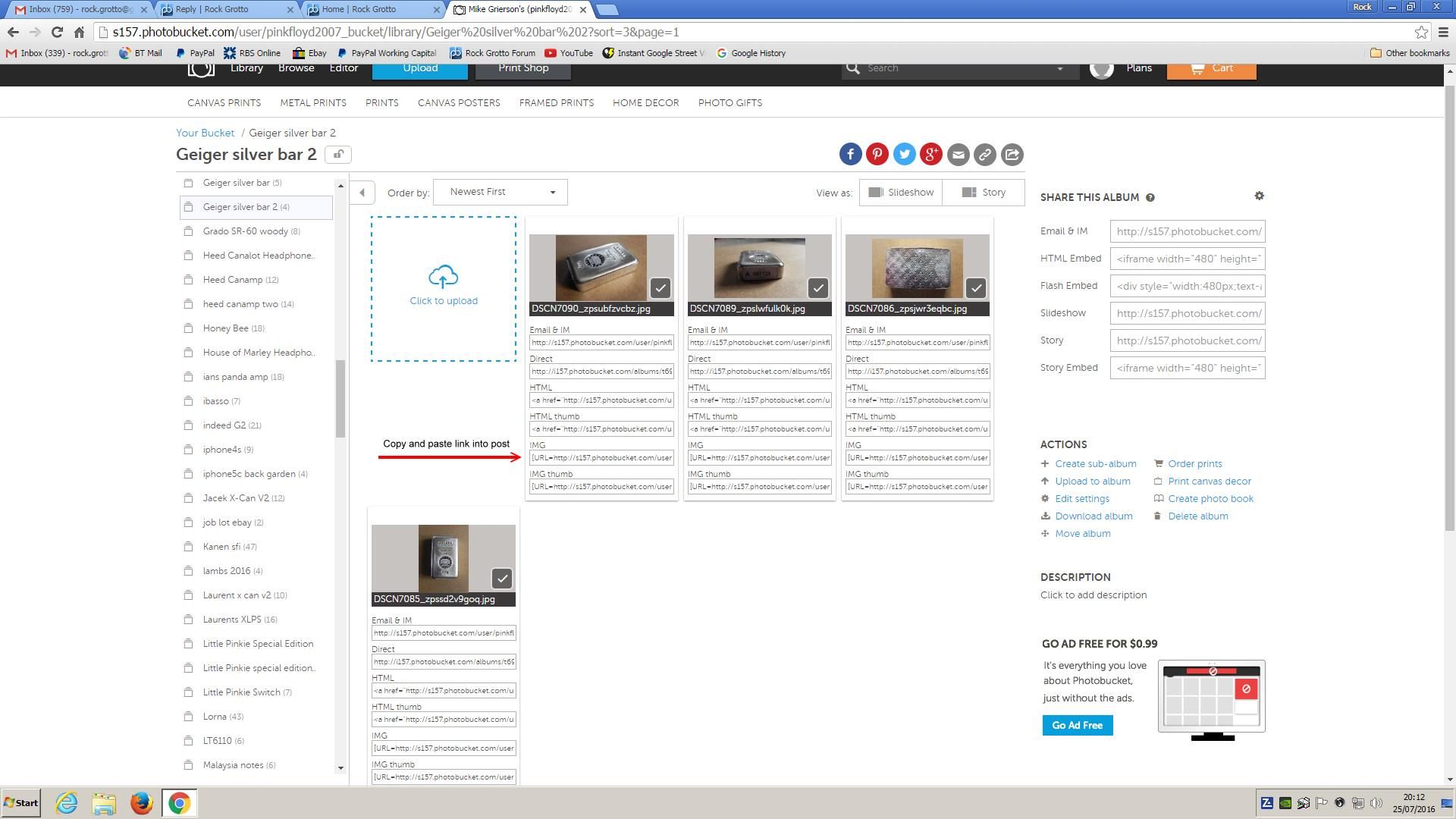

Post by brancolo on Jul 25, 2016 17:31:08 GMT
How to load images on this forum? It seems impossible
Post by PinkFloyd on Jul 25, 2016 19:23:05 GMT
How to load images on this forum? It seems impossible Hi Brancolo, Welcome to the forum. The forums image attachment is currently full so the best way to show images on the forum is to open a free account with photobucket, upload your photos to photobucket and then link them here. Once you have uploaded your photos to photobucket choose the photo you want to appear here, click on the IMG link and it will turn blue.... you then right click and choose "copy" and then "paste" the link into your post here..... the image will appear here as if by magic All the best, Mike.
Post by PinkFloyd on Jul 25, 2016 19:24:30 GMT
The result is this:
Post by PinkFloyd on Jul 25, 2016 19:25:27 GMT
Hope that makes sense? If not, contact me and I will help you out.
