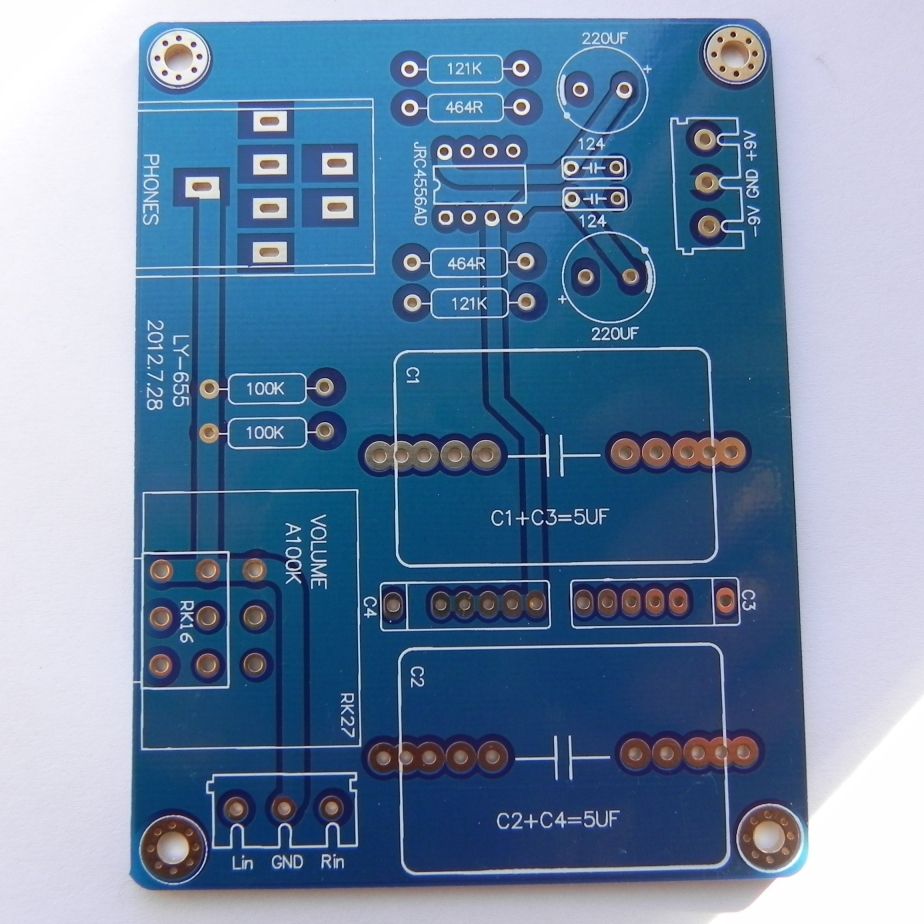

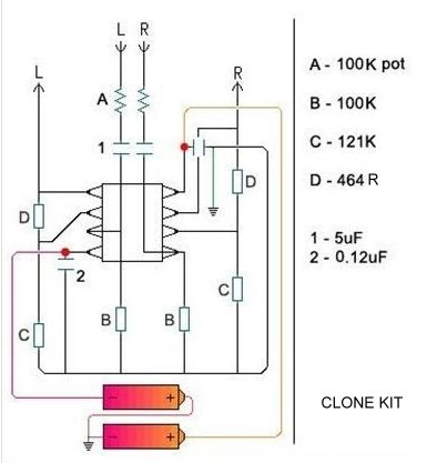

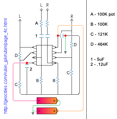

It has arrived but I'm a bit puzzled.......... The RA-1 amp uses a 464K resistor but this clone amp comes with a 464R resistor..... that's a big difference! The question is, what would you guys say was the correct value..... 464K or 464R? Here is the supposedly "correct" RA-1 schematic: Here is the clone RA-1 schematic: Both of them are from third parties so either one could be correct or both could be incorrect Here is a close up of the PCB.... it's a nice quality "weighty" double sided job: I'll upload photos tomorrow of the entire kit contents and then get round to putting it all together but my first priority is to establish the age old question....... "464K or 464R"?

Mike Obviously, the marked 464R in this antiquated circuit, which uses way too high resistor values in the input and feedback areas ,should be 464K which will give a gain of a little under 4 times.
Alex

Mike Obviously, the marked 464R in this antiquated circuit, which uses way too high resistor values in the input and feedback areas ,should be 464K which will give a gain of a little under 4 times. Alex Hi Alex, Glad you confirmed that mate.... there are tons of these out there and god only knows what they sound like with the 464R resistor fitted Yes, It may be antiquated and not cutting edge but at £13 GBP shipped it gives people the opportunity to hear the Grado RA-1 amp without having to fork out £420 GBP www.nintronics.co.uk/Headphones/headphone-accessories/headphone-amplifiers/grado-ra1-headphones-amp.html?Colour=12866&gclid=CKvh8s2-ucsCFdS7Gwod_jEE3AWe all know that the Grado RA-1 is this simple, antiquated circuit potted inside a wooden box but a lot of people seem to like it...... they will like it a lot more if all it costs them is £13 (plus wooden casket of their choosing) Strip her down and have a look at what the £420 GBP is buying you: Ooh err missus!
