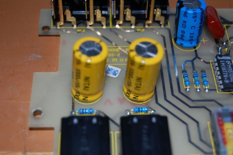

Post by senj on Mar 20, 2008 16:47:03 GMT
Just finished cleaning the board after soldering. Before: After: Anyone see any problems, before i put it back in and fry some headphones?
Post by PinkFloyd on Mar 20, 2008 17:53:12 GMT
Looks absolutely fine senj.... go and fire her up and see how she sounds
Post by senj on Mar 21, 2008 9:30:12 GMT
I'm still getting the background hiss. Are you getting a hiss and a slight crackle on yours too? It's noticable at the quiet passages. I might open her up again and check the soldering.
Post by Deleted on Mar 21, 2008 10:06:57 GMT
Mike and senj Why is there a WIMA .1uF capacitor across the diode near the DC input jack ? Does the other side of this diode connect to the on/off switch ? If so, it should not be there. If this diode is in series with the input from the DC supply, it will provide reverse voltage protection, as well as giving a little extra filtering, due to acting like a small value resistor between the output filter capacitor of the PSU and the input filter capacitor of the amplifier.(In effect, a CR network) In this case , connecting a capacitor across it will let more HF rubbish from the PSU through, although the extra 50/100HZ ripple rejection won't suffer. SandyK
Post by PinkFloyd on Mar 21, 2008 11:03:54 GMT
I'm still getting the background hiss. Are you getting a hiss and a slight crackle on yours too? It's noticable at the quiet passages. I might open her up again and check the soldering. Depends on what 'phones you are using with it senj?? If low impedance then, yes, there will be a slight hiss at zero volco. Totally silent with higher impedance cans.
Post by senj on Mar 21, 2008 11:19:41 GMT
I'm using the Ergo 2s. Which are about 100 ohms i think. Could it be the QED power supply i got with the amp?
